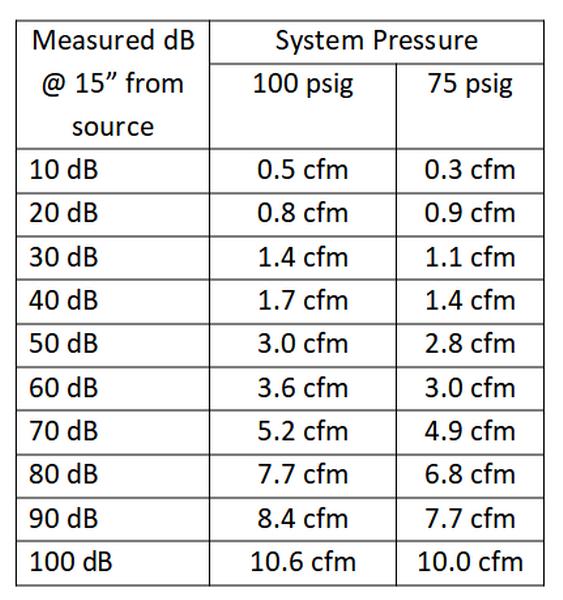

It is recommended that the individual performing the leak audit utilize an ultrasonic leak detector. The audible frequency range of hearing for the human ear is 20 Hz to 17kHz. Ultrasonic sound begins at 20kHz. The suggested setting of an ultrasonic leak detector being used for compressed gas leaks is 40 kHz., so the frequency range of most leaks is higher than what can be heard by the human ear. Many users find that most leaks are small, and only located by using an ultrasonic leak detector.
The table correlates system pressure, observed leak sound power level (dB) (at 15” from the source), and estimated leak volume. Leak table adapted from UE Systems “Guesstimator Chart.”
