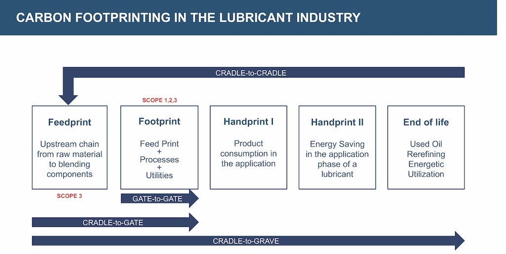

Feedprints, footprints, handprints and other terminology
Calculating a corporation’s carbon footprint begins with examining operations from factory gate to factory gate for each of the corporation’s worldwide locations and subsidiaries. It also requires identifying boundaries between the steps in the production, use and disposal chain for each product.
The Greenhouse Gas Protocol Corporate Standard for calculating a corporate carbon footprint is equivalent to the ISO 14064 standard, and it encompasses three scopes. Scope 1 involves carbon emitted directly as a result of running machinery, driving vehicles, heating buildings and other onsite operations. Scope 2 covers indirect (offsite) emissions created during the production of energy that an organization buys. Scope 3 emissions, which often account for more than 70% of a company’s footprint, are produced by suppliers that make products that the company uses or as a result of customers using products that the company sells.
Extraction and production of raw materials constitutes the “cradle” that starts a supply chain, and the resulting carbon emissions are referred to as the “feedprint” (see Figure 2). The lubricant manufacturer buys these raw materials or lubricant components made from these materials and brings them into the factory (the first “gate” in a gate-to-gate calculation). The manufacturer then makes finished lubricant products that it sells to its customers (the second “gate”). The carbon emissions involved in getting this product to the point of sale is the company’s carbon “footprint.” A cradle-to-gate calculation uses the total of the feedprint, the footprint and the utilities used in making the finished lubricant.
The lubricant manufacturer can evaluate the products it sells using benchmarks that represent a typical life cycle analysis, but ultimately, the customer is responsible for selecting and applying their lubricants. Customers buy finished lubricant products, which they use to reduce friction, wear and corrosion in their machinery. They look for products that lengthen oil drain intervals and reduce evaporation losses. Each of these factors reduces the lubricant’s “handprint.”
The point where a customer disposes a used lubricant is the “grave” in a cradle-to-grave calculation. Increasingly, however, stakeholders in the lubricants industry and their customers and suppliers are advocating for a “circular economy” approach. Once a lubricant reaches the end of its service life, it can be collected and regenerated or reprocessed into new base oils or feedstocks for the production of new lubricants—a cradle-to-cradle approach. This approach produces significant, measurable reductions in CO2 emissions to the atmosphere compared to virgin base oils or conventional base oils. Some waste oils with a high additive content cannot be regenerated, but they can be incinerated to generate heat rather than being discarded.

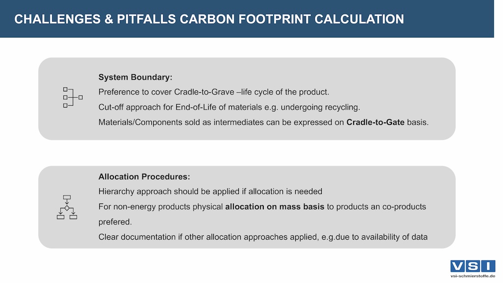

Boundaries, allocations and hierarchies
One important issue is the definition of the system boundary. Currently, methodologies exist that cover the cradle-to-grave approach—from the product’s feedprint to end of life—which requires constructing a description of the product’s life cycle. However, lubricant materials and components are often sold as intermediates, which requires a cradle-to-gate approach. This requires establishing boundaries that define where the gates are and what constitutes the product’s end of life. Clearly defined boundaries prevent double counting of CO2 emission reductions from, say, a lubricant manufacturer and the OEM they supply.
The cradle-to-gate approach only considers the emission reductions associated with the lubricant manufacturer’s processes, and not the potentially much greater contributions that these lubricants make to emission reductions resulting from the customer’s use of the lubricants. Because the lubricant manufacturer does not dictate how the customer uses the product, they cannot claim the credit for these emission reductions. A lubricant manufacturer can make recommendations to their customers on how to use their products in the most sustainable way, but ultimately the end-user bears the responsibility for their application of the product. Thus, the manufacturer’s contribution to the carbon footprint essentially ends when the product leaves the factory gate.
Another relevant aspect is the allocation procedure. Allocation approaches divide energy and emissions burdens among co-products based on their mass, energy or market value shares. Lubricants are non-energy products (i.e., they are not used as sources of energy), so physical allocation on a mass basis is preferred. If another allocation approach is applied, it must be clearly documented according to the ISO hierarchy described in their 14040, 14044 and 14067 standards.
A third aspect is a hierarchical approach to data sources. Primary data is the best option where it’s available, but primary data are often site-specific, or they come from different representative product systems, so it’s very difficult to align primary data from different sources. Secondary data (proxies, estimates and processes under investigation) require a conservative approach that recognizes the greater margin of uncertainty. As more and more reliable and realistic primary data become available, calculations can be revised to reflect a greater degree of precision.
