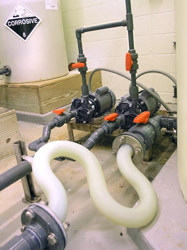

Corrosive chemicals are fluids that will attack and destroy the materials they encounter. Metals, stone, glass, elastomers, and even some types of plastics can be susceptible to corrosion from various fluids like acids, bases, and solvents. Some corrosive materials can even cause physical hazards when exposed to incompatible materials. For example, when exposed to an incompatible metal, many inorganic acids can release hydrogen gas, which can pose a fire and explosion hazard.

Corrosive chemicals are fluids that will attack and destroy the materials they encounter. Metals, stone, glass, elastomers, and even some types of plastics can be susceptible to corrosion from various fluids like acids, bases, and solvents. Courtesy: Finish Thompson Inc.
