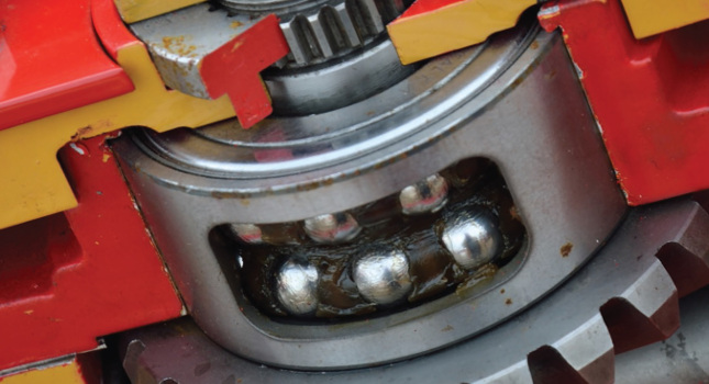

Greases are commonly used for bearings, gears, bushings, chain drives and wire ropes (see Figure 1). Between 80% – 90% of roller bearings are lubricated with greases because grease provides better sealing and load-carrying properties, and it shows a higher resistance to dirt, dust and temperature extremes than oil lubricants can provide. The tradeoff comes in grease’s poorer cooling properties (in part because the grease remains in place rather than circulating through the system) and in its viscous resistance (the drag that a grease layer exerts on moving parts).
