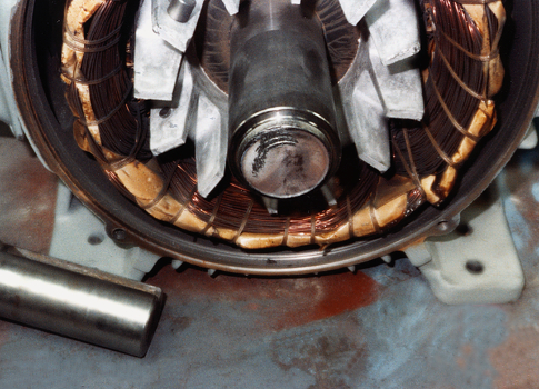

Shaft size is dictated by torque, not horsepower. But changes in horsepower and speed (rpm) affect torque, as the following equation shows:
Torque (lb-ft) = hp x 5,252/rpm
Accordingly, an increase in horsepower would require more torque, as would a decrease in rpm. For example, a 100 hp motor designed for 900 rpm would require twice as much torque as a 100 hp motor designed for 1,800 rpm. Each shaft must be sized for the torsional load it is expected to carry.
Two basic approaches are used to determine the required minimum shaft size for motors, both of which yield conservative results. One method calls for making the shaft large enough (and therefore strong enough) to drive the specified load without breaking. Mechanical engineers define this as the ability to transmit the required torque without exceeding the maximum allowable torsional shearing stress of the shaft material. In practice, this usually means that the minimum shaft diameter can withstand at least two times the rated torque of the motor.
Another way to design a shaft is to calculate the minimum diameter needed to control torsional deflection (twisting) during service. To engineers, this means the allowable twisting moment, or torque, is a function of the allowable torsional shearing stress (in psi or kPa) and the polar section modulus (a function of the cross-sectional area of the shaft).
Machinery’s Handbook provides the following equations for determining minimum shaft sizes using both design approaches: resistance of torsional deflection and transmission of torque. Both sets of equations are based on standard values for steel, with allowable stresses of 4,000 psi (2.86 kg/mm2) for power-transmitting shafts, and 6,000 psi (4.29 kg/mm2) for line-shafts with sheaves (sometimes called pulleys). Some of the equations also are specific to keyed or non-keyed shafts, which is handy for pump users who need to know how to calculate both keyed and unkeyed shafts.

The other way to calculate minimum shaft size for a motor is to set a limit on the amount of torsional deflection (twisting) that may occur. Resistance to torsional stress is directly proportional to shaft size: the larger the diameter, the greater the resistance to twisting.
A rule of thumb with this method is that the shaft must be large enough that it will not deflect more than 1 degree in a length of 20 times its diameter. To calculate the minimum shaft size to meet this specification, use the following equation:
Example 2
For the 200 hp (150 kW), 1,800 rpm motor from Example 1, the minimum shaft size to limit torsional deflection would be:
Or, in metric units:
The minimum shaft diameters calculated by the torque transmission and torsional deflection methods are essentially the same for Examples 1 and 2. Still, a good approach is to calculate the size both ways, and then use the larger value as the absolute minimum.
