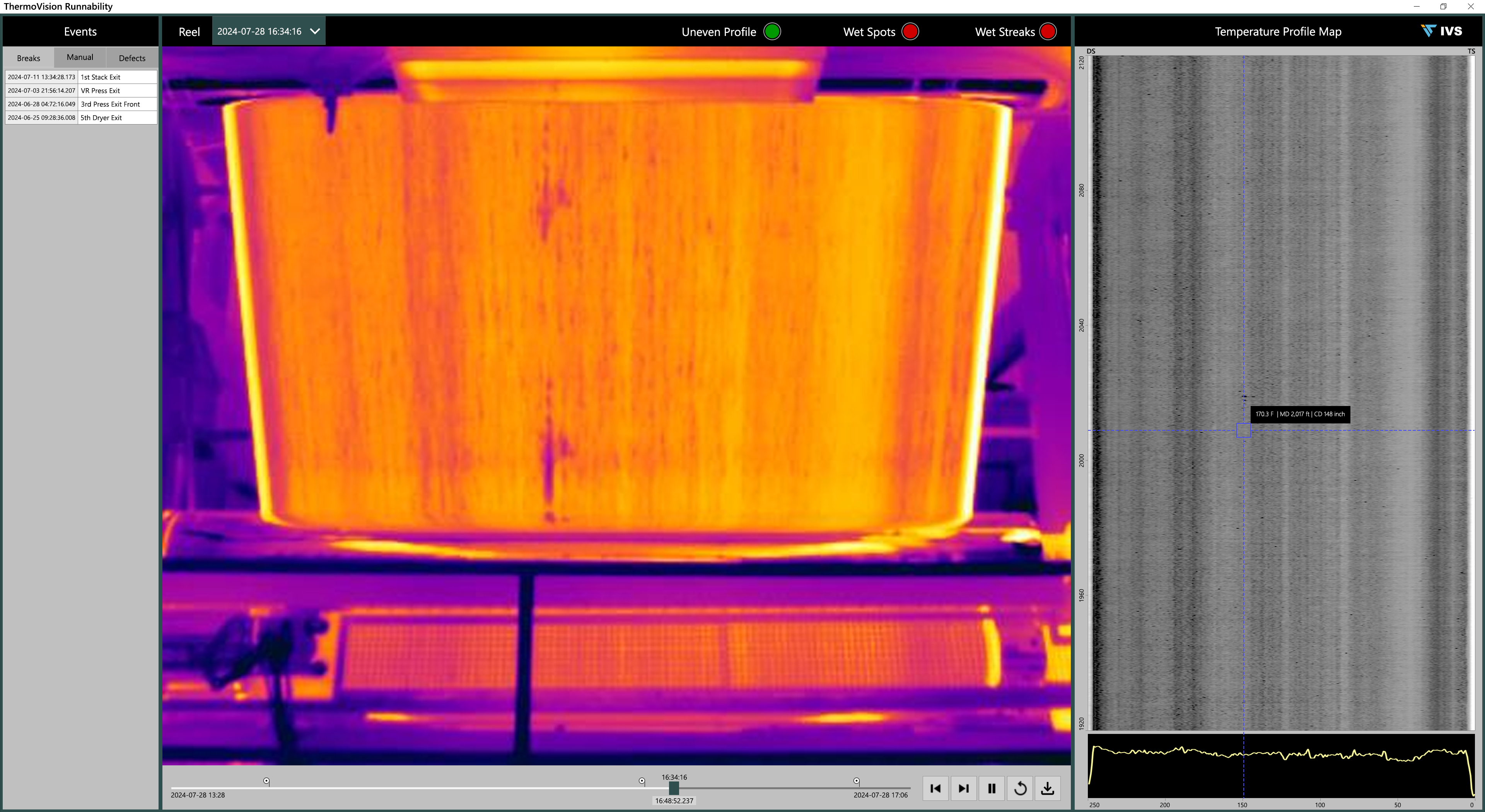

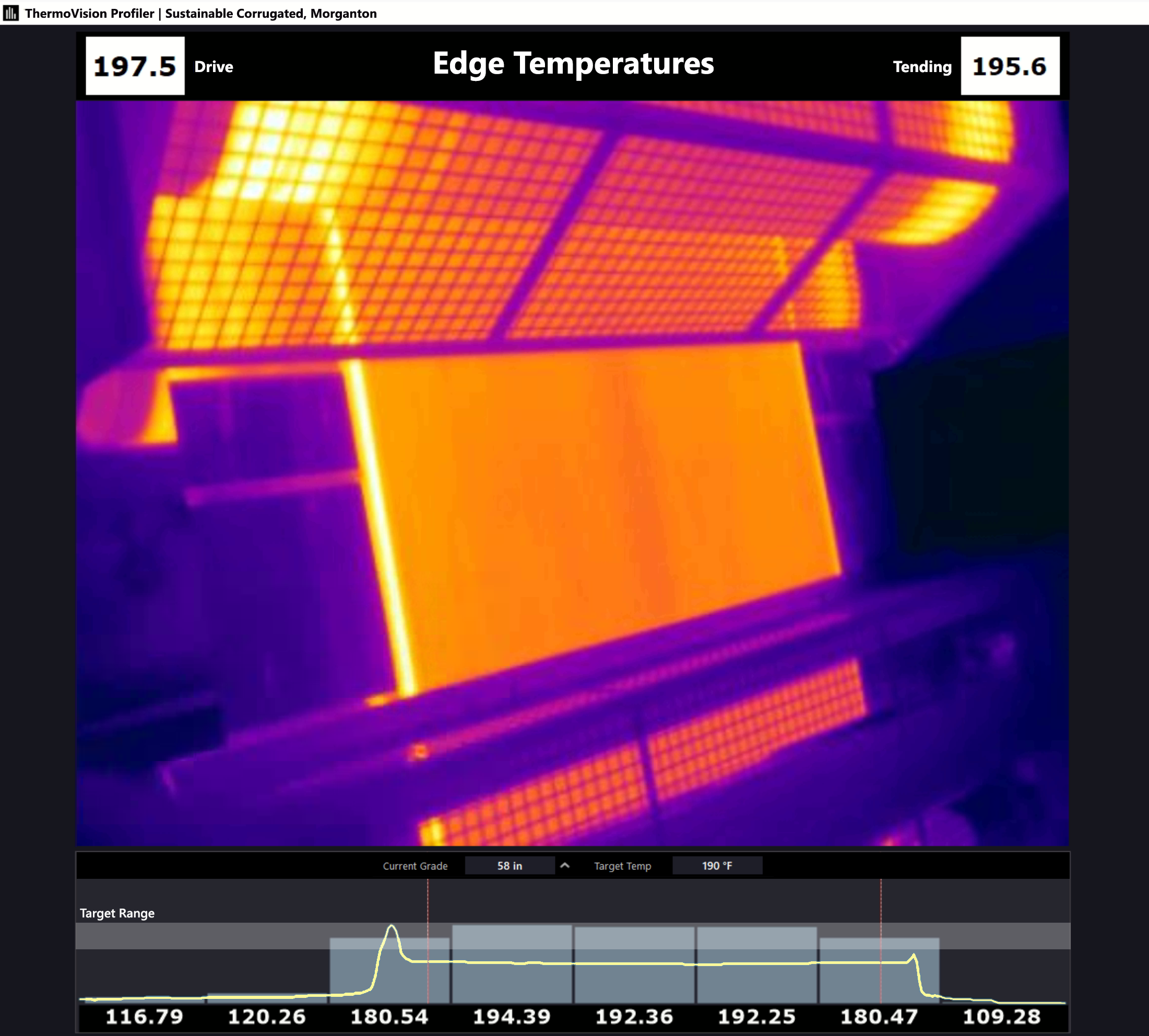

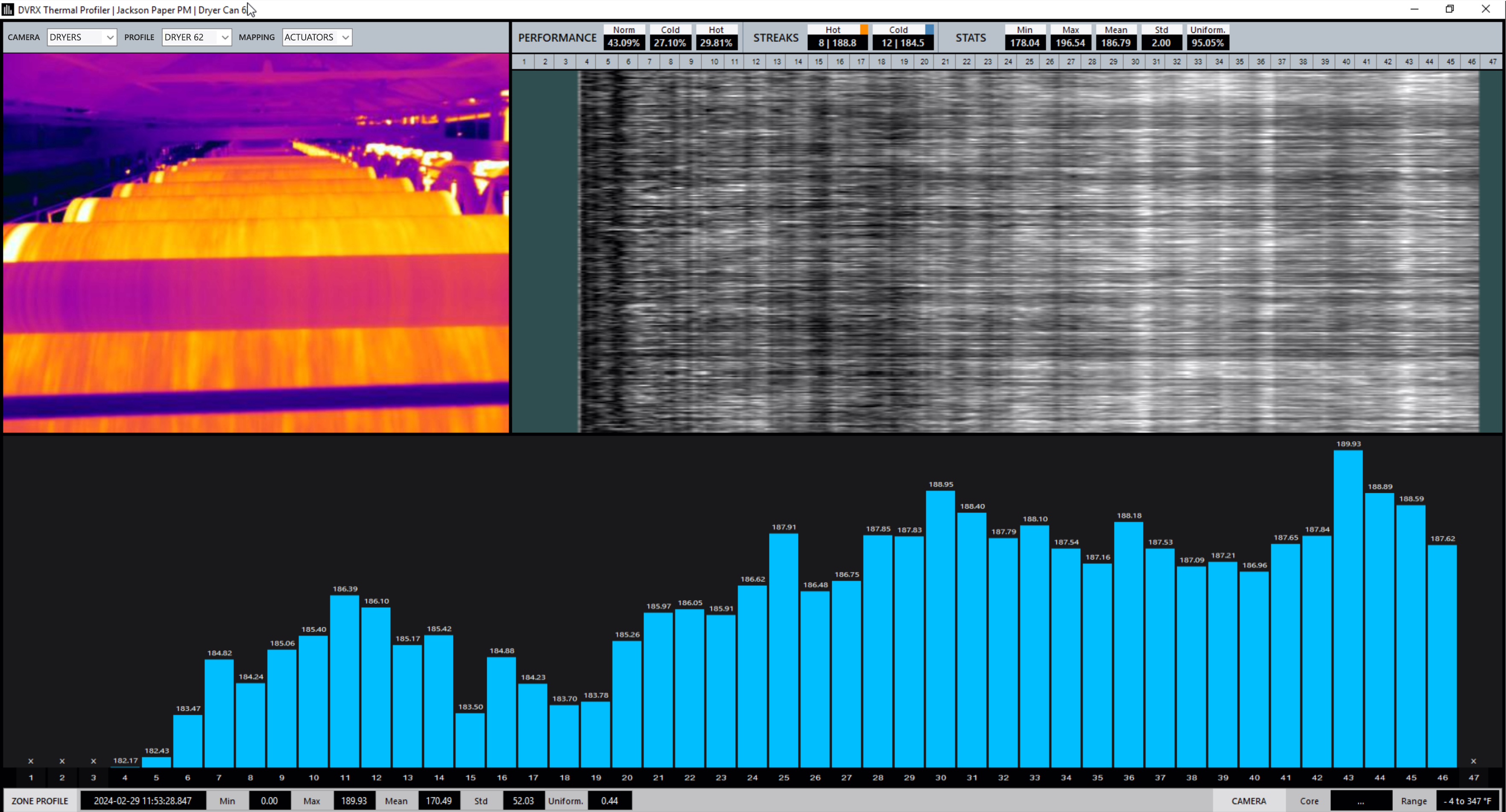

The solution arrives in the shape of ThermoVision, an IVS-patented system featuring FLIR IR cameras at its core. With its FLIR cameras, ThermoVision sees real-time moisture profiles in any paper machine location, mapping them to a multi-functional thermal profiler. The system can provide real-time, full-width, cross-direction (CD) moisture and temperature profiles, as well as real-time machine direction (MD) profile variations. Moreover, profile analytics provide insights into dewatering and drying efficiency – critical for energy benchmarking.
ThermoVision facilitates the real-time detection and classification of wet streaks and spots, as well as the real-time detection of embedded foreign materials, such as metals in fluff pulp. A key capability of the system is its ability to provide visibility in steamy machine locations. Using a FLIR IR camera to capture an image of a pulper vortex, for example, allows users to see through steam and visualize the vortex in full detail, including the position of the chain and vortex edges. This ability is indispensable for monitoring locations within the machine like trim squirts and dryers.

There are essentially two ways of adopting ThermoVision on a papermaking machine. First, as an add-on to existing sheet break systems. FLIR IR cameras see ‘invisible’ defects that visual spectrum cameras cannot. The system also detects wet streaks in real time, helping to prevent costly sheet breaks that can lead to hours of downtime.
Second, the system can involve sending the sheet-wide thermal profile to a quality control system (QCS) scanner. A QCS scanner moves back and forth across the sheet, a process that takes anything from seconds to minutes. However, using data captured by FLIR IR cameras, it is possible to feed the QCS in real time. While the control system will not likely work in real time, capturing images with FLIR IR cameras at 30 frames per second, for example, means the system can provide an average profile every second, supporting ultra-fast control system decisions.
“A big issue with a QCS scanner is its location at the end of a papermaking machine,” explains Mr Frackowiak. “From placing pulp on the wire, ready for manufacturing into paper, to running through the entire machine and reaching the QCS scanner, no quality measurement checks take place. However, by positioning a FLIR IR camera at the beginning of the process, perhaps in the press section, we can immediately detect defects like wet streaks or incorrect moisture profiles. This is important because some start-up processes can take hours, with papermaking plants unable to thread the web due to problematic sheet breaks. We now have a way of letting them know why, saving significant time.”
