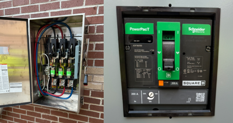

Fuses: A fuse is the quintessential example of protection through intentional material failure. It is the electrical system’s sacrificial lamb, designed to permanently break the circuit when a fault occurs to protect the load.
At the core of a fuse is the fuse element, a conductive wire or strip calibrated to melt when heated. The governing principle is that I2R heating (Joule heating) causes the element’s temperature to rise. When the current exceeds the fuse’s ampere rating for a sufficient duration, the element reaches its melting point and blows, creating an open circuit. This ensures quick isolation of the system’s faulty section, whether the cause is a short circuit or a prolonged overload.
Fuses are characterized by their simple mechanics, leading to diverse applications based on voltage and current requirements:
  • Cartridge fuses: Cylindrical devices housed in an insulating fiber or ceramic tube, commonly used in control panels and motor circuits.
  • Blade fuses (automotive fuses): Feature a nonencased metal strip for low-voltage direct current systems.
  • High-voltage fuses: Used in utility distribution and substation equipment, these are often filled with arc-quenching materials like borax or use compressed gas like sulfur hexafluoride (SF6) to safely interrupt the high-energy arc that forms during interruption.
Fuses are simple, reliable, cost‑effective and fast-acting during short-circuit events, which makes them well-suited for many basic protection applications. Because they have no moving parts to wear out, they offer robust performance. Their primary limitation is that they must be replaced after clearing a fault, resulting in additional maintenance and downtime.
Figure 3: Examples of overcurrent protection devices, including a fused disconnect switch (left) and a Molded-Case circuit breaker (right), which automatically interrupt excessive current to protect electrical conductors and equipment from damage. Courtesy: CDM Smith
Circuit breakers: A circuit breaker is an electromechanical reusable guardian that performs the same protective function as a fuse but is designed to be easily reset after a fault condition is corrected, providing significant operational flexibility and reduced maintenance costs.
The circuit breaker relies on two distinct mechanisms to handle the two primary types of faults:
  • Thermal trip (overload protection): This action handles sustained overloads where current exceeds the beaker rating. It uses a bimetallic strip composed of two metals with unequal thermal expansion rates. The heat generated by the continuous overcurrent causes the strip to bend and mechanically trip the circuit breaker contacts. This is a time‑delayed mechanism because the bimetal strip must heat and deform before tripping, allowing for harmless, temporary current spikes while ensuring operation under sustained overloads.
  • Magnetic trip (short-circuit protection): This mechanism provides instantaneous interruption for short circuits and extreme overcurrent. A short circuit generates an enormous current surge, which passes through a solenoid (electromagnet). The resulting powerful magnetic field instantly pulls an armature, bypassing the thermal mechanism and tripping the breaker contacts in milliseconds. This rapid response is crucial for minimizing damage from catastrophic faults.
Circuit breakers are scaled and specialized based on the fault current they must interrupt:
  • Molded-case circuit breakers: Enclosed in a rugged insulating case and used for main distribution feeders and heavy industrial loads. They often feature adjustable trip settings, providing customization for specific applications.
    • Miniature circuit breakers: Smaller versions used in lighting panels. They offer a more compact footprint and often lack adjustable settings.
  • Air/gas/vacuum circuit breakers: Employed in high-voltage transmission and distribution networks, these use sophisticated techniques (SF6 gas or vacuums) to effectively extinguish the high-energy arc and safely interrupt power.
Unlike fuses, circuit breakers can be reset after a fault once the issue has been addressed. They also offer more sophisticated features, including customizable selective coordination via settings and integrated ground-fault/arc-fault protection.

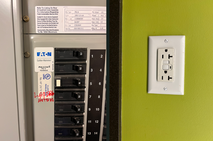

Figure 4: Example of layered personnel protection, showing an upstream arc fault circuit interrupter circuit breaker (left) supplying a downstream ground fault circuit interrupter receptacle (right) to mitigate arc-fault and ground-fault hazards. Courtesy: CDM Smith

Modern electrical systems demand robust safety measures to protect both people and equipment from multiple hazards. Advanced alternating current circuit protection technologies have become essential components in commercial and industrial environments, addressing risks such as electric shock, fire and equipment damage. By integrating specialized devices that detect faults and mitigate surges, these systems form a comprehensive defense against the most common and dangerous electrical threats.
Ground fault circuit interrupters (GFCIs) protect against electric shock by monitoring the current flowing into and out of a circuit. When a small imbalance is detected, typically 4 to 6 milliamperes, the device interrupts power to prevent current from passing through a person or unintended grounding path. These are especially critical in wet or damp environments like bathrooms and kitchens.
Arc fault circuit interrupters (AFCIs) are designed to reduce the risk of electrical fires caused by damaged wiring or loose connections. These devices analyze current waveforms and detect high-frequency components (typically in the 40 to 100 kilohertz range) associated with series or parallel arcing faults, disconnecting power when hazardous arcing conditions are identified.
Surge protection devices (SPDs) limit damaging voltage spikes caused by lightning strikes or utility switching events by diverting excess energy away from sensitive equipment. SPDs are rated by their nominal discharge current, voltage protection level and maximum continuous operating voltage. They are typically installed at service entrances or distribution panels to protect downstream equipment.
When applied together, these devices provide layered protection against overloads, short circuits, ground faults, arc faults and overvoltage, preventing potential damage to sensitive electronics.

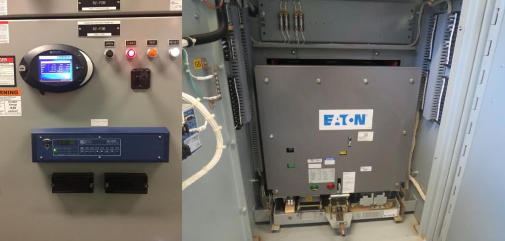

Protective relays are the brain of a medium-voltage protection system. They continuously monitor current, voltage and frequency and they isolate the circuit when faults occur. Digital relays offer advanced functions, such as fault location, event logging, remote communication and selective coordination. This ensures that only the faulted circuit is isolated, preserving service for unaffected areas. Without accurate relay operation, protection systems would be slow and ineffective, jeopardizing both equipment and personnel safety.
Selective coordination is both an art and a science, ensuring that protective devices operate in a logical sequence during faults. In medium-voltage systems, proper selective coordination means downstream devices clear localized issues while upstream devices remain intact. Engineers achieve this through time-current curves and selective settings, balancing speed with reliability and safety. Poor selective coordination can lead to unnecessary outages, increasing stress on equipment and risking power outages. Therefore, coordination is essential for maintaining system function and isolating affected electrical equipment.
Figure 5: Medium-voltage switchgear illustrating a digital protective relay (left) and a draw out medium voltage circuit breaker (right), which work together to detect faults, selectively isolate affected circuits and maintain distribution system reliability. Courtesy: CDM Smith
