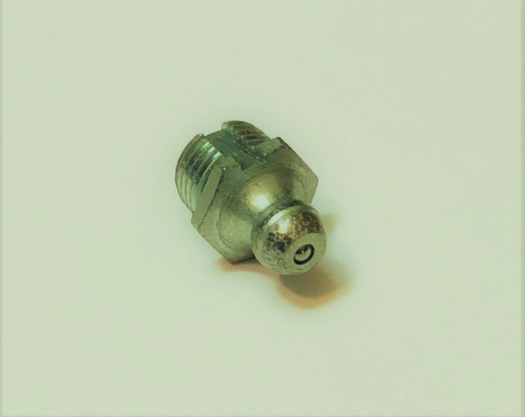

Cleanliness
Although I knew to not put the grease gun tip in dirt and to keep dirt out of the grease inside the gun, I never thought about the grease zerk (see Figure 1). Of course, I would knock off clumps of dirt from the zerk, but I did not realize the ball valve in the zerk has a small groove around the exposed portion of the ball that collected dust and dirt. By not thoroughly cleaning the grease zerk before greasing, I was pushing the dirt into the bearing or journal, promoting excessive wear. In my defense, I did not see that dirt. The unaided eye can only see particles down to about 40 microns in size. I learned much later that it is the “invisible” particles, smaller than 40 microns, that get between the lubricated sliding and rolling surfaces and, thus, cause excess wear. Ideally, I would have left a little grease on the zerk after greasing to seal the zerk’s ball valve against dirt. Then, a quick wipe of the zerk would remove the small amount of grease, and dirt, off the zerk before greasing the next time. Today, grease zerk caps are available for keeping dust and dirt off the zerk between greasings, so long as they are not knocked off or lost.
- Figure 1. Slotted grease zerk. Courtesy of: STLE
