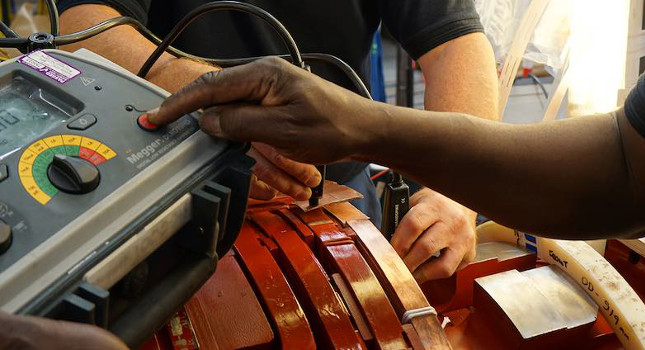

In the service center, the initial visual condition of the generator had already highlighted some detrimental issues. The complete rotor body was covered in rust and the single-length aluminum wedge was corroded and flaking away across the entire length. As-received electrical tests were carried out before the retaining rings were removed.
A cross connection coil was found to have migrated with bare copper only millimeters away from the earthed shaft. A catastrophic failure would have occurred if there had been contact while in service. The overall insulation system on the rotor was also found to be very poor. The retaining rings were corroded and both failed ultraviolet dye penetrant testing. Ultrasonic testing on the single sleeve bearing also highlighted extensive de-bonding of white metal from its parent backing material.

The complete rotor was rewound with new insulation and the cross-over connection was redesigned to eliminate any future migration. Once completely rebuilt, the rotor was electrically tested and dynamically balanced in a high-speed balance pit.
