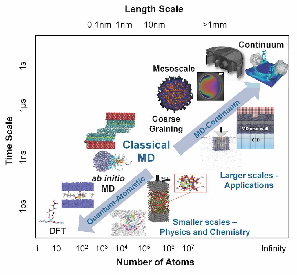

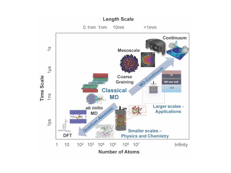

In a comprehensive technical review of contact modeling, Vakis and colleagues describe multiscale modeling as: “A technique in which two (or more) different models related to different [scales] (or different matter descriptions) interact, i.e., exchange data, in a way that enhances the information that can be obtained about the model phenomenon.”
Figure 1 illustrates some modeling techniques that are used to study contacts. Various contact modeling solutions promising to overcome the scale issue are already available, although they tend to be optimized for solving specific problems. They span a vast range in complexity, cost and functionality and have been used in many practical applications to solve real world problems, for example to study friction in train wheels.
Figure 1: Tribological systems are simulated with different techniques at different scales. An area of current interest is linking molecular dynamics (MD) simulations to smaller scales through quantum mechanical descriptions (ab initio or first principles MD models and density functional theory [DFT] models) and to larger scales through continuum models (including computational fluid dynamics [CFD] models).
Figure 1: Tribological systems are simulated with different techniques at different scales. An area of current interest is linking molecular dynamics (MD) simulations to smaller scales through quantum mechanical descriptions (ab initio or first principles MD models and density functional theory [DFT] models) and to larger scales through continuum models (including computational fluid dynamics [CFD] models). Courtesy: Daniele Dini/STLE
In principle, feeding results from one scale to another should yield more accurate results: for example, if information about molecular interactions that determine the formation of protective tribofilms (calculated from quantum mechanics and/or molecular dynamics simulations) is passed to models that predict friction under lubricated conditions at the macroscale. In fact, when the processes at different scales are essentially separate, this type of “hierarchical” model can be relatively accurate and problem-free. That isn’t automatically the case, however, for a couple of reasons.
