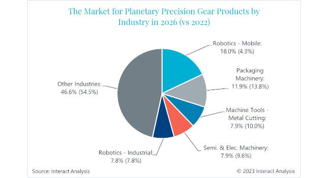

We predict the market for planetary precision gears will change substantially between 2022 and 2026, with mobile robots surging ahead to account for 18% of products sold by 2026 (up from 4.3% in 2022). The chart below shows how the mobile robots segment is expected to overtake packaging machinery over the 4 year period, with 2022 data in brackets for comparison.
Packaging machinery is currently the largest market for planetary gear products, but mobile robots is the fastest-growing.
In contrast, planetary gear sales are not expected to grow by more than 5% year-on-year in other industries, making mobile robots the fastest-growing market segment by far, with a predicted CAGR of 55% for 2022-26.
The huge growth within the mobile robots sector is driven by an increasing demand for warehouse automation, following the fallout from the COVID-19 pandemic, which led to a boom in e-commerce. From visiting trade shows such as Hannover, Automatica and SPS, it’s clear many suppliers are developing components targeting the mobile robots market. We anticipate the vast majority of mobile robots employing precision gear products will have planetary gears (~95%). There are very small amounts forecast to be fitted with strain wave or cycloidal technology, as mobile robots do not require the ultra-high precision for positioning and moving that they offer.
Packaging machinery is currently the largest market for planetary gear products, but mobile robots is the fastest-growing. Courtesy: Interact Analysis
