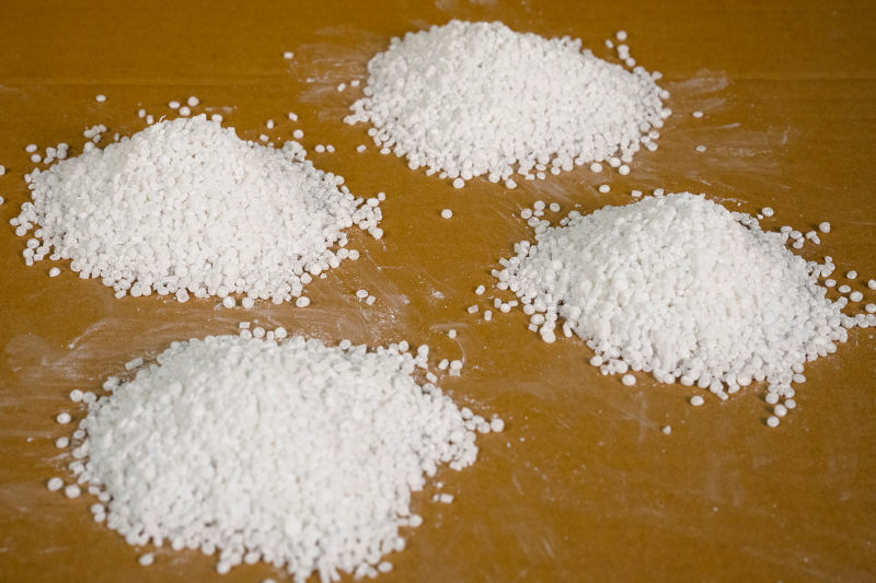

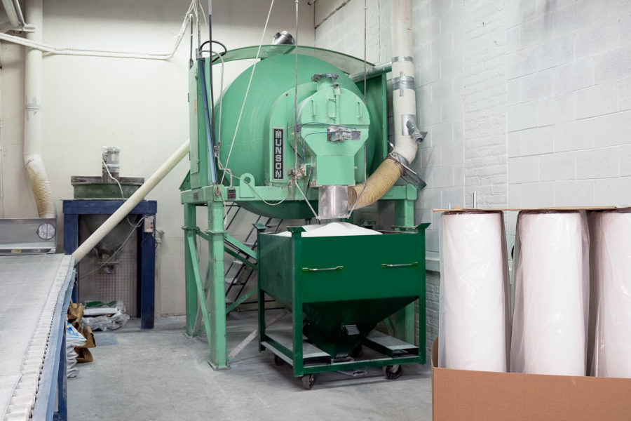

HMT first blends the ingredients, primarily pellets of hydrocarbon resins and polyethylene waxes, as well as a mineral-based powder filler, a job handled since 1994 by a model 700-TS-40-MS rotary batch mixer from Munson Machinery. Its horizontal vessel rotates on external trunnion rings located at each end, eliminating the need for an internal shaft and precluding material contact with bearings and seals.
In the mixing room a rotary batch mixer distributes resins, waxes and fillers uniformly in 1,000 lb. batches.

The mixer, which has a useable batch capacity of 40 cubic feet, operates in a dedicated room that also houses a belt conveyor, bag breaking station and screw conveyor. Here, an operator transfers 55 lb. bags of ingredients from pallets to the belt conveyor, which terminates at a bag dump station into which material is dumped. An integral screw conveyor transfers the material into the inlet of the mixer while it is rotating. Once the last bag is added, the mixer continues running for 20 minutes.
Ingredients are emptied into a hopper from which a flexible screw conveyor transfers them to the intake of the rotary batch mixer.
Ingredients are emptied into a hopper from which a flexible screw conveyor transfers them to the intake of the rotary batch mixer. Courtesy: Munson Machinery.
“Some batches are actually done in about five or 10 minutes, but we find that 20 minutes is ideal for all our formulas,” Bennett said. “It’s also a comfortable speed for the operator.” When necessary, minor ingredients can be added manually through a side door.

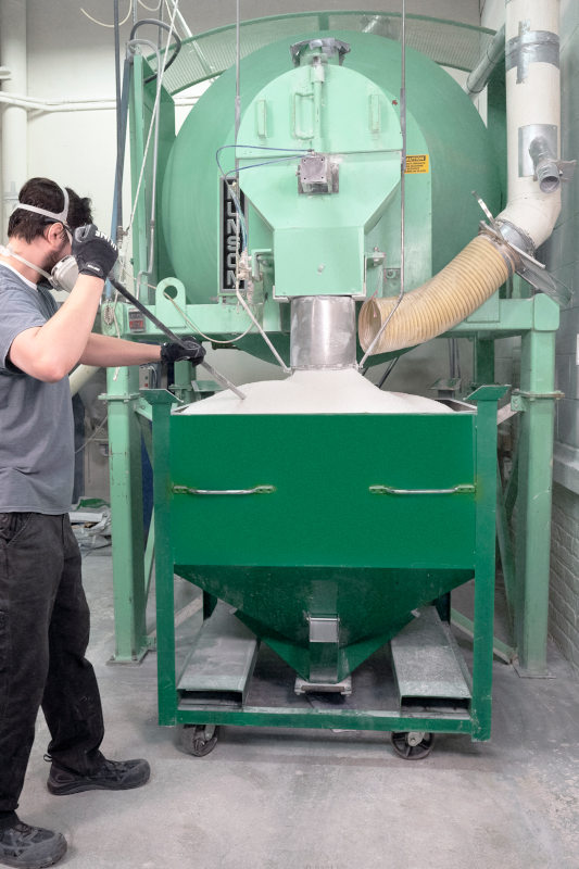

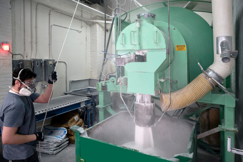

At the end of the cycle, the operator flips a switch, actuating an air cylinder that opens the mixer’s stationary outlet. With the vessel continuing to rotate, the 1,000 lb. batch discharges through a collapsible chute into a mobile bin. Dust collection pickups are located at the mixer’s outlet, at the screw conveyor’s discharge and at the bag breaking station. The mixer itself operates dust-tight with a single radial seal preventing dust leakage.
Once filled, the bin is wheeled to low-pressure extruders, which feed the mixture into the hot melt film-casting process. HMT has eight standard formulas, each with six or seven ingredients. The plant averages six batches a day.

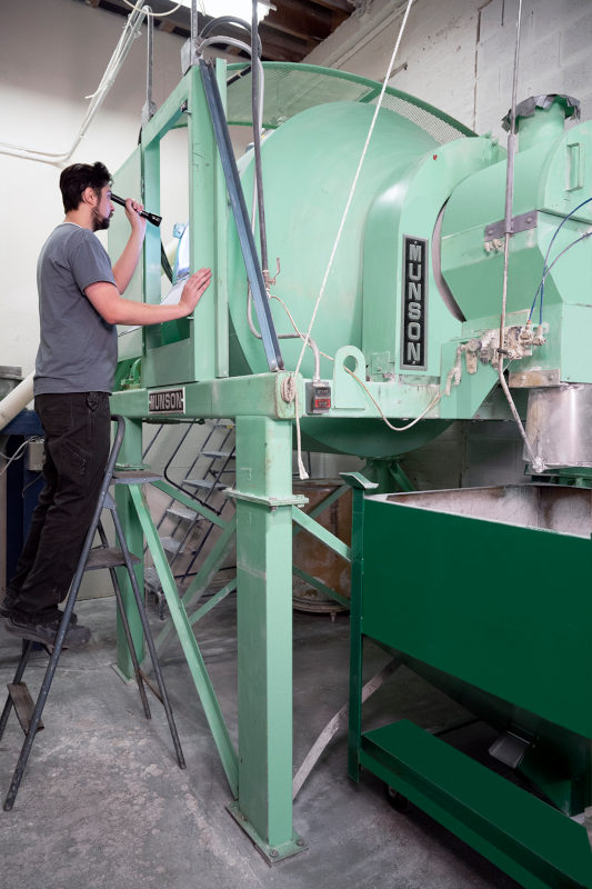

Clean-out doors allow unrestricted access to the mixer interior. The horizontal vessel rotates on external trunnion rings located at each end, with no internal shaft or bearings contacting material being.

Bennett has not detected any wear inside the mixer from the abrasive mineral-based filler, although dust has prompted the company to make two repairs. The first was replacing the packing seal at the mixer’s inlet where the screw conveyor discharges. “It wasn’t affecting the performance, but it allowed dust to drift,” Bennett says. The second was replacing the air cylinder that opens the discharge gate after the seals wore out from contact with the abrasive dust.
