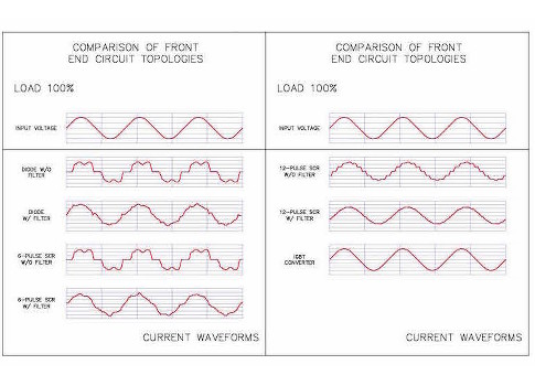

Converters/rectifiers
The main purpose of the converter section of the UPS is to convert the ac utility power to dc power. The amount of harmonics can vary greatly, depending on the type of converter. The most popular power electronics used for this process are the diode (6-pulse), the thyristor (SCR 6-pulse and SCR 12-pulse) and the insulated-gate bipolar transistor (IGBT). The IGBT converter has proven to reduce harmonics without the use of a transformer.
The 12-pulse SCR rectifier uses an isolation transformer in combination with two 6-pulse SCR rectifiers. The 30-deg phase shift provided by the transformer is the main purpose of the isolation transformer. The two 6-pulse SCR rectifiers will alternate to create twice as many pulses. The 12-pulse SCR rectifier will produce fewer harmonics than the single 6-pulse SCR rectifier, allowing for a smaller harmonic filter.
The diode bridge converter is similar to the 6-pulse SCR rectifier, except the diodes are natural commutation (natural on and natural off). The benefits of the diode bridge are better efficiencies and lower harmonics as compared to a traditional SCR rectifier.
Every rectifier, regardless of the technology or power electronics used, will produce harmonics. For all technologies but the IGBT, these harmonics are greater than desired for most electrical systems including the backup generator. Therefore, an input filter is required to reduce the harmonics to less than 10% of the total harmonic distortion of the input current. The input filter is comprised of an inductor with a parallel capacitor. If there is a transformer, it helps add inductance to the line to further reduce the harmonics.
Figure 1 above shows reflected harmonic distortion on input current waveforms from their respective rectifier or converter technology.
Although some manufacturers have started using IGBTs in the converter section, most are still switching the IGBTs based on the traditional SCR logic. The benefit of using a slower switching speed for the IGBT converter is a higher efficiency (less switching means less switching losses). In this case, the IGBT converter will still produce larger amounts of harmonics, which will require the input harmonic filter (similar to the harmonic filter for the SCR rectifiers).
