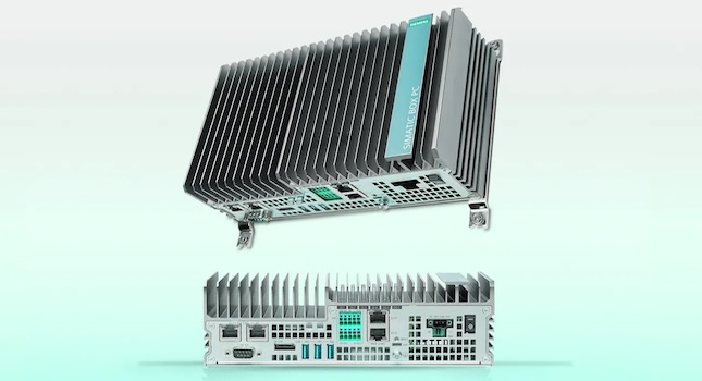

Multiple form factors of industrial PCs, including box PCs for computing close to the machine, rack PCs for complex processes, panel PCs for visualization tasks and mobile devices for remote operations. Courtesy: Siemens

Reducing short-term costs using mass-produced computing solutions can lead to long-term risks. IPC vendors offer much higher standard capabilities than commercial systems, with memory and processing that can be customized for applications. Made-to-order IPC systems undergo rigorous testing of each component upon assembly to ensure no defective or sub-spec parts could cause intermittent failures or experience a shorter-than-expected life span. This quality analysis process may include X-ray inspection, hardware limit tests and long-duration software stress tests. IPC systems may also integrate high-level processing power typically required for specific AI and simulation applications.
Graphics processing units-based industrial PC made for artificial intelligence inference applications including vision inspection, defect detection, predictive maintenance and automated guided vehicles. Courtesy: Siemens
