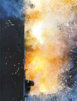

Arc flashes are responsible for about 80% of electrical accidents in the U.S. each year.
Arc flashes happen when an electric current passes through the air between two conducting metals—an arc fault. Almost instantly, an arc can superheat the air around it to a temperature up to 35,000 F—about four times the sun’s surface temperature. This extreme heat ionizes all nearby materials, including copper, insulation, and metal enclosures, creating explosive gaseous plasma as those materials expand to many thousands of times their solid volumes.
Under these conditions, the copper changes to plasma, with a volume about 67,000 times that of its solid form. Or, stated differently, each cu in. of copper converts to almost 39 cu ft. of copper vapor.
Arc faults are different from bolted faults on the load terminals of standard, metal-enclosed switchgear. Switchgear equipment is designed to withstand bolted fault currents until circuit breakers or fuses interrupt the current flow. When a bolted fault occurs, the voltage at the point of the fault is virtually zero and the total fault energy gets dissipated into the entire power system, while any arcs are contained and cooled within the circuit breaker’s interrupters or the fuses.
By contrast, the incident energy of an arcing fault is much more difficult to contain and is concentrated almost entirely at the fault location. Its flash can spread hot, ionized plasma over a distance of 20 ft. or more with significant accompanying sound and shock waves. This explosive force can cause significant injury, even death, to individuals in the immediate vicinity.
Arc flashes are responsible for about 80% of electrical accidents in the U.S. each year. In human terms, they are responsible for hundreds of deaths, thousands of serious injuries, and significant lost work time every year.
