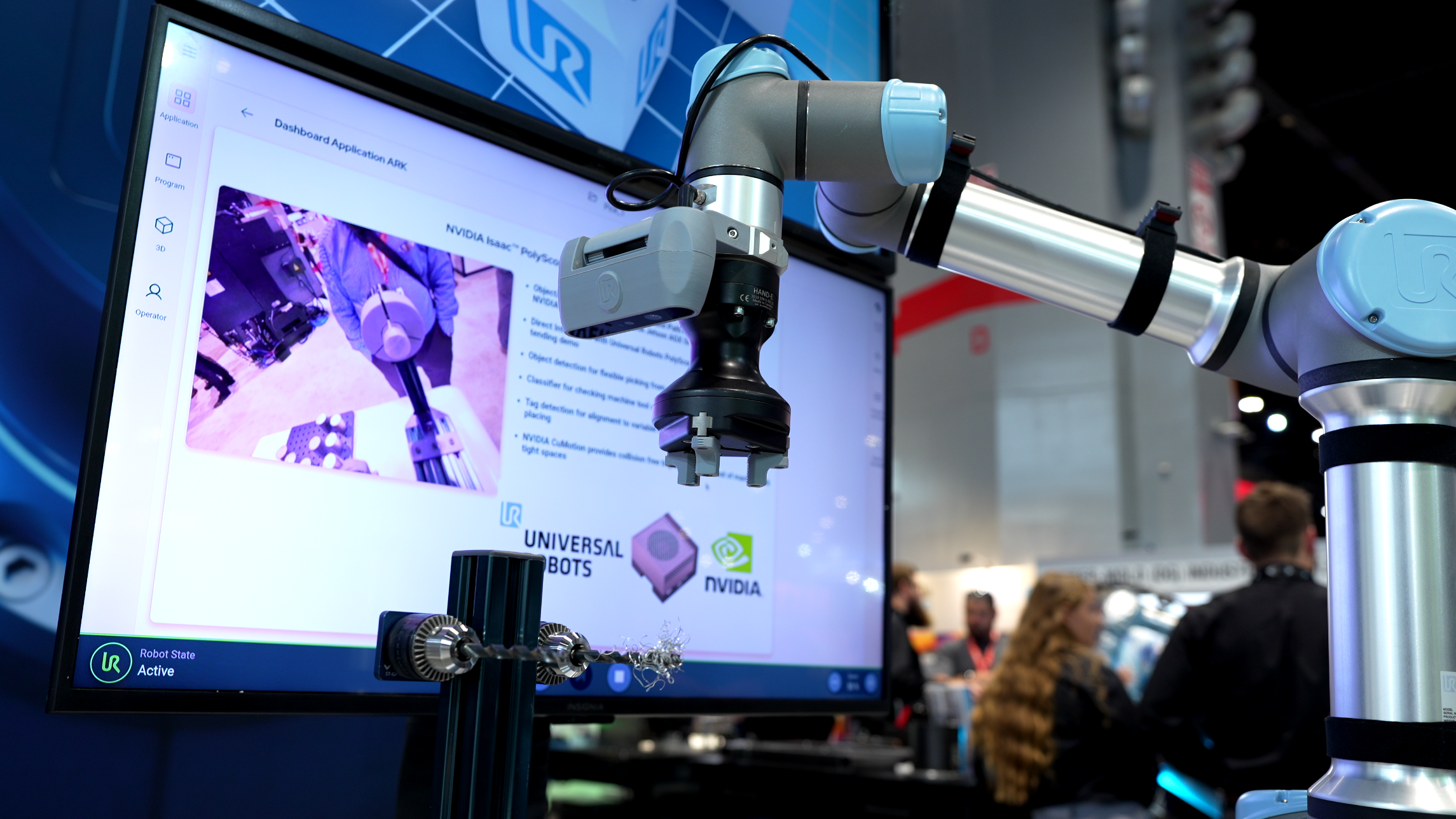

Figure 1: Universal Robots launched the AI Accelerator. The toolkit is enabled by UR's next-generation software platform PolyScope X and is powered by NVIDIA Isaac accelerated libraries and AI models, running on the NVIDIA Jetson AGX Orin system-on-module. The toolkit also includes the Orbbec Gemini 335Lg 3D camera. Depicted here from the ROSCon exhibition 2024 is a demo of the AI Accelerator with a computer numerical control machine tending application using a UR5e. Courtesy: Universal Robots
Figure 1: Universal Robots launched the AI Accelerator. The toolkit is enabled by UR’s next-generation software platform PolyScope X and is powered by NVIDIA Isaac accelerated libraries and AI models, running on the NVIDIA Jetson AGX Orin system-on-module. The toolkit also includes the Orbbec Gemini 335Lg 3D camera. Depicted here from the ROSCon exhibition 2024 is a demo of the AI Accelerator with a computer numerical control machine tending application using a UR5e. Courtesy: Universal Robots

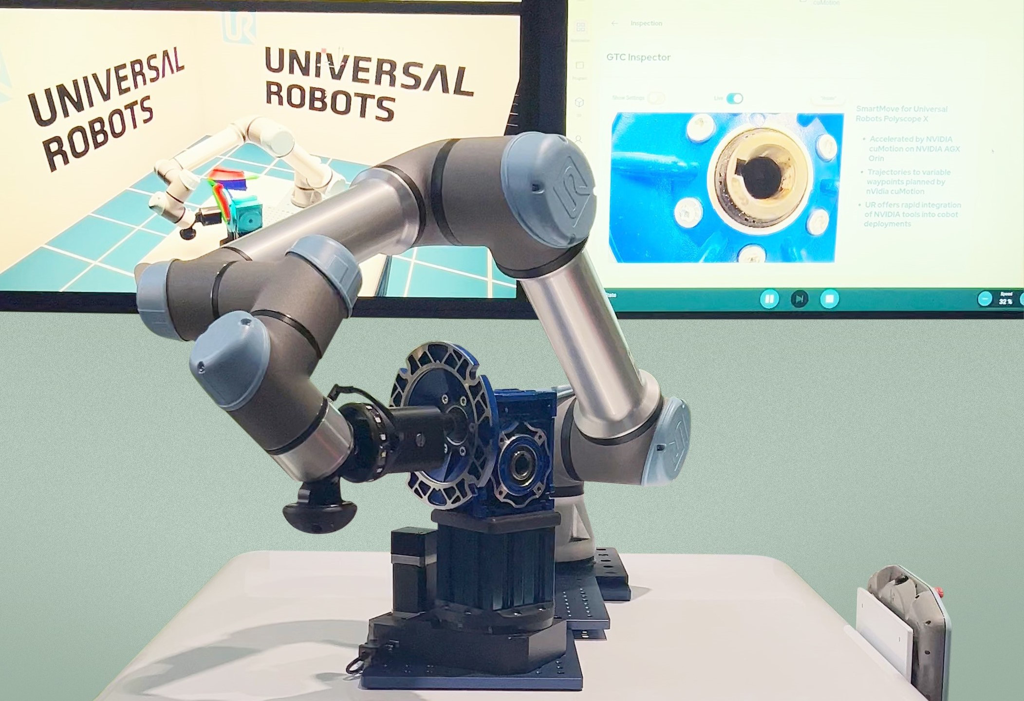

Figure 2: Universal Robots previewed the AI Accelerator at IMTS 2024 in Chicago. Courtesy: Universal Robots
