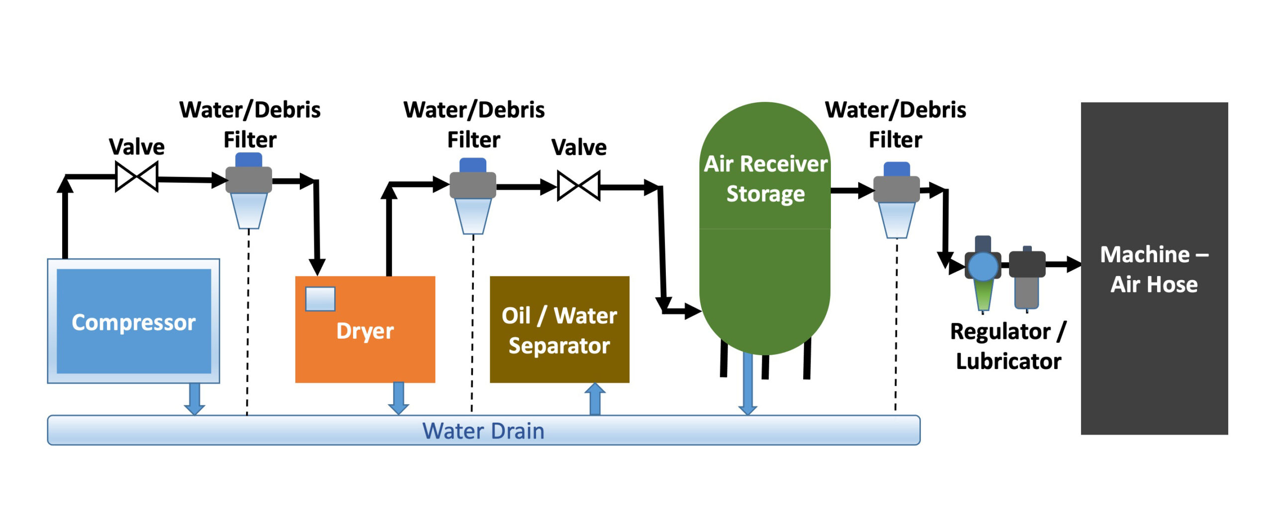

A control panel coordinates timing between a compressor, dryer, oil/air separator, air receiver storage tank and user equipment (see Figure 2). Ambient air first passes through the inlet and the gas is pressurized during compression. This air contains water vapor and soluble impurities from the atmosphere. During compression, the air heats adiabatically. The warm air passes to a thermal dryer whose purpose is to remove water. The compressed air is directed towards receiver tanks for stowage and expands thereby lowering the temperature and dewpoint of air in the tank. Water condenses and typically accumulates at the bottom of the receiver tanks. This water should be drained frequently to keep relative humidity in the receiver tank low. Unfortunately, this action does not take place in practice. A distribution system delivers supposed dry, compressed plant air to pneumatic subsystems consisting of a filter, regulator, lubricator, solenoids, pistons, and various other air-actuated equipment.
 Figure 2. A depiction of a pneumatic equipment line in a plant is given. The flow of compressed air through systems to an end use is represented. Courtesy: A.W. Chesterton.

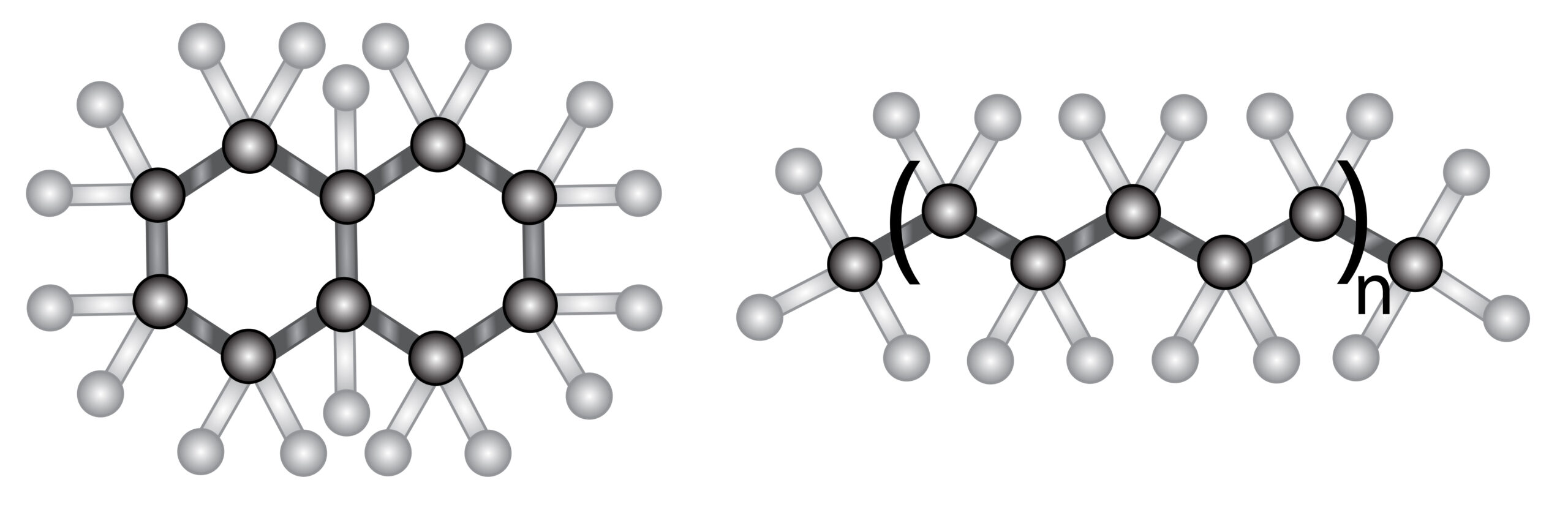

Base oil. One must use an appropriate base oil(s) for air-actuated systems. Naphthenic (see Figure 4), natural esters, synthetic esters and polyalkylene glycols are most compelling. Unfortunately, pure paraffinic oil (see Figure 4) is the common choice due to cost and availability but provides low performance. Paraffinic oil possesses low-oxidation stability, provides minimal water displacement, gives ineffective sediment dispersion and reacts with moisture to produce acidic sludge, varnish and surface corrosion. Hydraulic oils often contain pure paraffinic oil and are incorrectly used in pneumatic applications.
Figure 4. Chemical structures of naphthenic (left) and paraffinic (right) oil where n = 24-38 are shown. Courtesy: A.W. Chesterton.

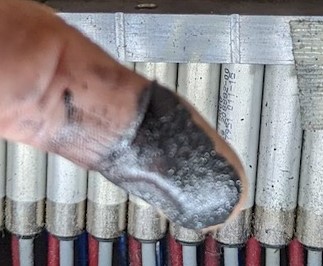

Extensive field studies and repeat customers have benefited from Chesterton’s 650 AML in pneumatic systems (see Figure 5). Sticky residue was eliminated, hardware reverted to near pristine state and an odorless feature was emphasized at food processing plants. More accurate cycle counts, corrosion reduction, and non-staining characteristics were observed at facilities.
Figure 5. An example of Chesterton’s 650 AML field trial study is provided. Courtesy: A.W. Chesterton.
