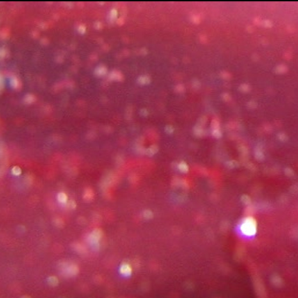

  • Grease displacement: Air can displace grease from the desired surface, causing loss of lubrication.
  • Incorrect amount of grease applied: When adding grease by volume, air entrainment can cause the addition of less grease than needed.
  • Compressed air: Compressed air under pressure can cause the air bubbles to collapse, an effect called cavitation. When the bubbles collapse, they emit a shock wave, which can cause damage to the parts. Compressed air can reach elevated temperatures causing the grease to oxidize or even start a fire.
Selecting a supplier that makes the removal of air prior to packaging a priority is an essential first step to avoiding air entrainment. Transferring grease from one container to another should be avoided to reduce the introduction of air.
Figure 2: This depicts air trapped in grease. Courtesy: CITGO Lubricants
