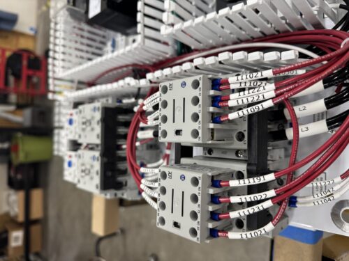

Figure 1: Highlighting the complexities of a two-speed reversing motor control setup. Courtesy: Concept Systems Inc.

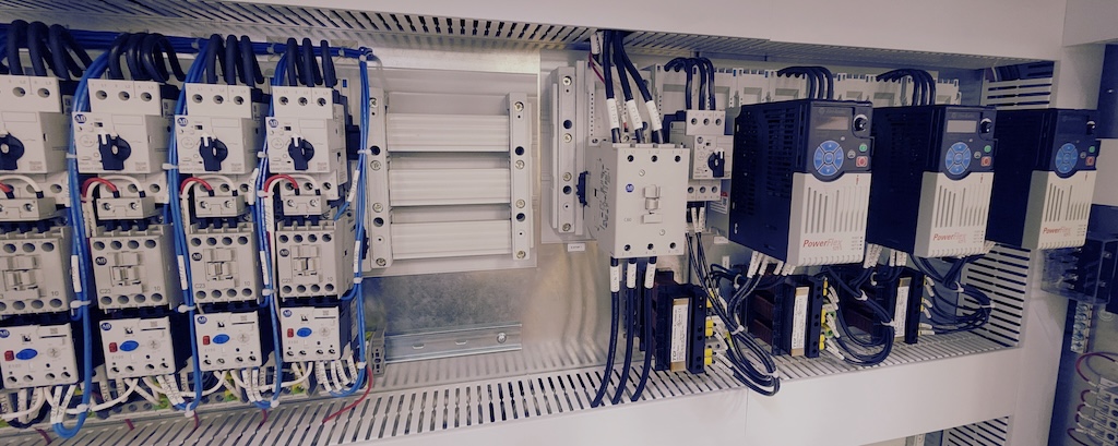

Figure 2: Variable frequency drives reduce wiring within control panels. Courtesy: Concept Systems Inc.

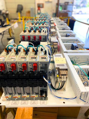

Figure 3: Modern servo drives with Ethernet communication enhance precision. Courtesy: Concept Systems Inc.

In motor starter applications, the removal of electrical power at the motor creates a coast to stop scenario. This coasting makes it difficult to pinpoint where to place sensing devices to account for the delay in stopping. While external sensing devices are still required, VFDs can actively ramp down or dynamically stop instead of coasting. Servo drives with their closed-loop sensing via motor encoders can actively stop at a motor angle instead of physical position in space. This enhanced precision creates a smoother running line and allows a for multiple systems to better synchronize to each other.
