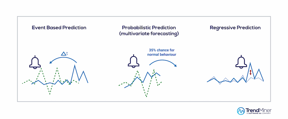

Figure 1: Advanced industrial analytics uses three approaches to help engineers select the right time to perform maintenance. Courtesy: TrendMiner

As shown in figure 1, advanced industrial analytics uses three different prediction approaches. The first is based on events. For example, engineers can receive an alert with instructions if an event occurs that could negatively affect another part of the process. The second approach is probabilistic. In this approach, advanced industrial analytics reviews the current process behavior, determines if a failure is likely and automatically schedules work orders with instructions if necessary. The third type of approach is regressive, which requires certain conditions be met and verified before maintenance receives work orders or instructions.

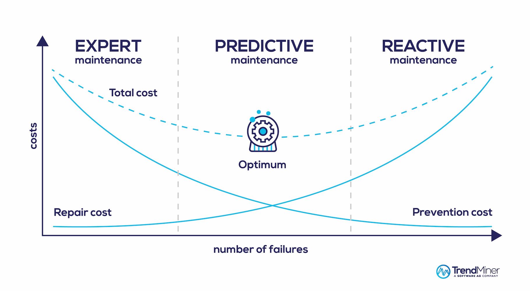

Predictive maintenance aims to schedule maintenance at a time not only when it is the most cost-effective, but also when it will have the least effect on operations (see Figure 2). To get the prescription for each possible prediction or to learn the best time for preventive maintenance, all equipment and process-related sensor data should be used. This is called “contextualization of asset performance with process data,” which makes data-driven prescriptive maintenance become possible.
Figure 2: The goal of prescriptive maintenance is to find the time when the cost and downtime of the maintenance is justified to reduce the number of failures in production. Courtesy:
