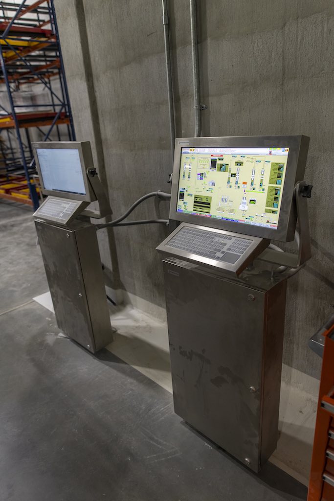

Figure 2: The Interstates I-Control software provides track and trace capabilities, lot tracking, reporting, recipe management, and integration with all supplied equipment. Courtesy: Interstates

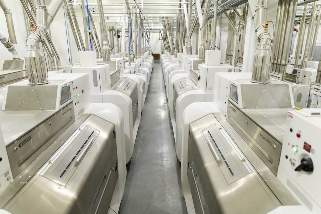

Figure 3: Buhler MRRA rollstands with their onboard integrated machine control networked to the plant automation system. Courtesy: Interstates

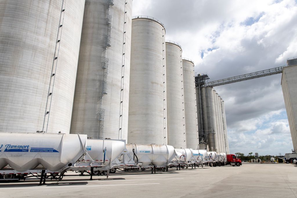

Figure 6: Port Redwing is one of 45 Ardent Mills facilities throughout the United States, Canada, and Puerto Rico, with grain storage capacity constructed alongside the mill totaling 4.1 million bushels. Courtesy: Interstates
