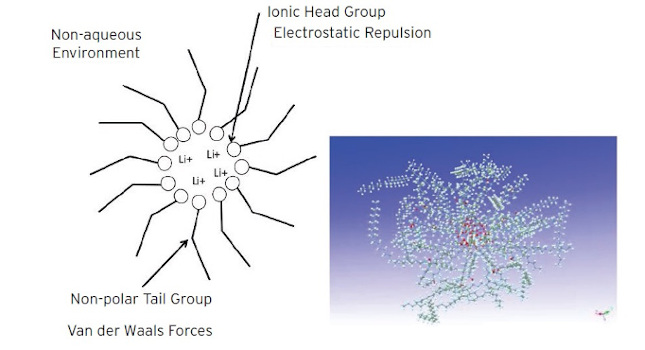

Micelles
Thickeners all self-assemble into threadlike molecular structures, called micelles, that allow a compound that is normally insoluble to dissolve. Micelles form when soaps and detergents are added to water. The individual molecule has a strongly polar head and a non-polar hydrocarbon chain tail. When this type of molecule is added to water, the non-polar tails aggregate into the center to form a ball-like structure (micelle). This aggregation is due to Van der Waals Forces between the molecules (see Van der Waals Forces). Because they are hydrophobic, the polar head of the molecule faces outward for interaction with the water molecules on the outside of the micelle, while the tail faces inward. (See figure 3)
Van Der Waals forces
According to Wikipedia, Van der Waals Forces are relatively weak, short-range attractive forces that act on neutral atoms and molecules and arise because of the electric polarization induced in each of the particles by the presence of other particles. These forces include attraction and repulsion between atoms, molecules and surfaces, as well as other intermolecular forces. The forces result from a transient shift in electron density. As the electrons orbit the nucleus within an atom, the electron density may tend to shift more to one side. This generates a transient charge (i.e., an induced dipole) to which a nearby atom can either be attracted or repelled. When the inter-atomic distance of two atoms is greater than 0.6 nm, the force is so weak that it is not strong enough to be observed. When the inter-atomic distance is below 0.4 nm, the force becomes repulsive.
Since lubricants are non-polar environments, these micelles are reverse or inverse micelles. The non-polar tails face outward and the ionic head faces inward. So it is the micelle structures in thickeners that allow the thickener to hold onto the lubricant (See figure 4).
