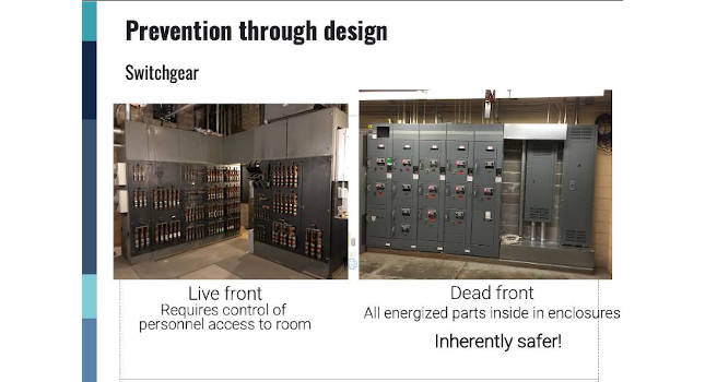

Q: What are the Europeans actually doing that results in lower electrical accident rates?
A: It is likely not just one thing. However, in 1988, the European Union established requirements for risk assessment that impacted design of tools, components, equipment and facilities a result, the concept of Prevention through Design is firmly entrenched in European safety culture. The US NIOSH Prevention through Design National Initiative launched in 2007 was based on the need to promote the concept in the US.
