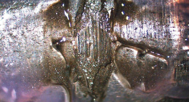

Figure 2: Wear scar on a steel test pin used to evaluate the performance of an experimental grease. Shiny wear particles are scattered within the grease. (Figure courtesy of Blau, P. J. (2016), Tribosystem Analysis, A Practical Approach to the Diagnosis of Wear Problems, CRC Press: Boca Raton, FL.)[/caption]
