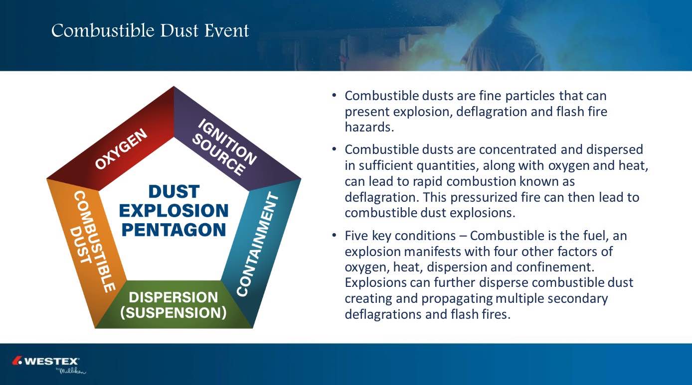

10. Most dust testing requires the dust sent in must be dried out to a low moisture content. How do you get the testing lab to test at the moisture of the dust being conveyed?
Ask the specific testing lab. The lab likely needs to have the dust (fuel) in the form (dispersion), so that it will combust in the test cylinder. For combustion to take place the dust (fuel) has to have proper particle dispersion, along with the other conditions for combustion, heat, oxygen.
