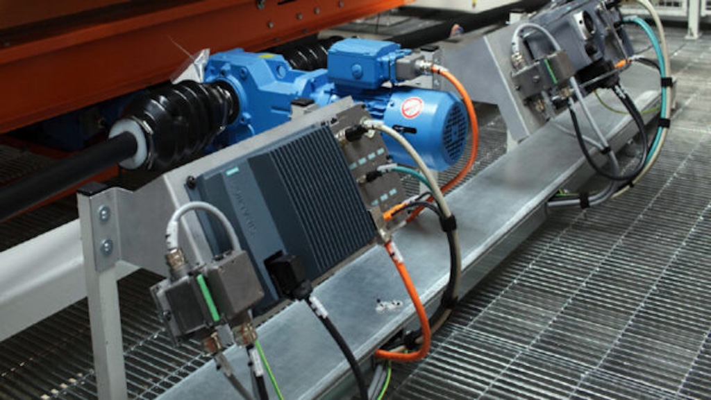

Many industrial applications require multiple drives mechanically coupled to a common load. When specifying a new or retrofit multiple-drive system, you are confronted with several choices of motor and drive technologies. In addition, you may have to evaluate an existing inventory of motors and drive components for possible reuse.
Load sharing concepts
Consider the example of a conveyor system carrying parts and assemblies to various locations throughout a manufacturing facility. As each location performs a particular function, such as machining, painting, drying, loading, and unloading, the system must respond to the resulting load transients and speed deviations by distributing the load among the drives.
Take for example an overhead chain conveyor system utilizing two, 5-horsepower motors to move engine blocks. When a block is placed on the conveyor in the loading area, drive motor A sees the load first and slows down. Slower chain movement near A causes an increase in chain tension between A and B, forcing B to produce more torque. As a result, B slows down to speed-match A. As both motors speed-match, they also share the load. The transient is absorbed by both motors and the system returns to a state of equilibrium.
This load sharing occurs only under very specific circumstances. Optimum design requires physically locating the drives so each is pulling its share of the load. Several loading conditions, including inclines and declines, complicate the process of locating the drives. This example is based on ideal system conditions. Additional circuitry is almost always necessary to ensure true electrical and mechanical load sharing. Both ac and dc drive systems are capable of load sharing, but they each employ very different control strategies.

AC drives have become extremely reliable and are rapidly becoming the number one choice of industry. Take for example a two-motor conveyor system using commonly available variable frequency drives. Most ac drive products are microprocessor-based and tend to offer more performance adjustments than needed. Dynamic responsiveness, often a bragging point, is rarely a critical issue. In fact, stiff speed regulation makes load sharing impossible.
For most industrial material handling applications, an open loop volts/Hz-type ac drive is appropriate. The term volts/Hz refers to a control strategy based on a proportional relationship between applied stator voltage and frequency. An induction motor produces constant torque as long as a fixed relationship is maintained between voltage and frequency.
Variable frequency voltage supplied to the motor stator by the vast majority of ac drives is a pulse width modulated (PWM) wave form, which determines the motor field strength. By making adjustments to the volts/Hz profile, each motor can be made to pull its share of the load without overloading.
Generally, so many adjustment parameters are available that custom volts/Hz profiles are unnecessary. Instead, torque compensation gain dynamically controls voltage boost to the motor. This boost is most effective at starting, when one conveyor section normally carries a greater percentage of the load.
Slip compensation is another adjustment that provides trim to the stator frequency based on the current. Slip compensation controls a slight offset to the volts/Hz profile, modifying the motor’s torque output, and is most effective at higher speeds. In the event these adjustments produce insufficient results, modifying the volts/Hz profile will have a more profound influence on motor torque. Again, each ac drive can be fine tuned to accommodate virtually any load characteristic.

Process systems often require multiple drives that must work together with great precision. Here, load sharing is accomplished without any form of external trim adjustment. A common control method used is the torque regulated speed follower (TRSF). Many ac and dc drive manufacturers have employed this control strategy.
TRSF provides speed follower control in combination with current (torque) control. Drive torque is regulated under normally loaded conditions, and automatic speed follower control acts in the event of a sudden drop in output torque. Within the control algorithm, the torque reference is compared with the actual torque to produce a speed trim error. As a result, when the actual torque is less than the set torque reference, the resulting error speeds up the drive, increasing output torque. If the opposite is true, the drive slows down, decreasing output torque.
Motor torque is well regulated through the use of this speed variable. Of course, this design requires that each motor have its own drive. Originally, torque references were exchanged between drives through an analog 0-to-10-V command. However, with the increasing number of digital ac/dc drive products, these variables are now passed over high-speed communication networks.
