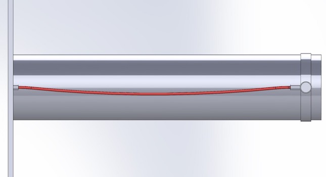

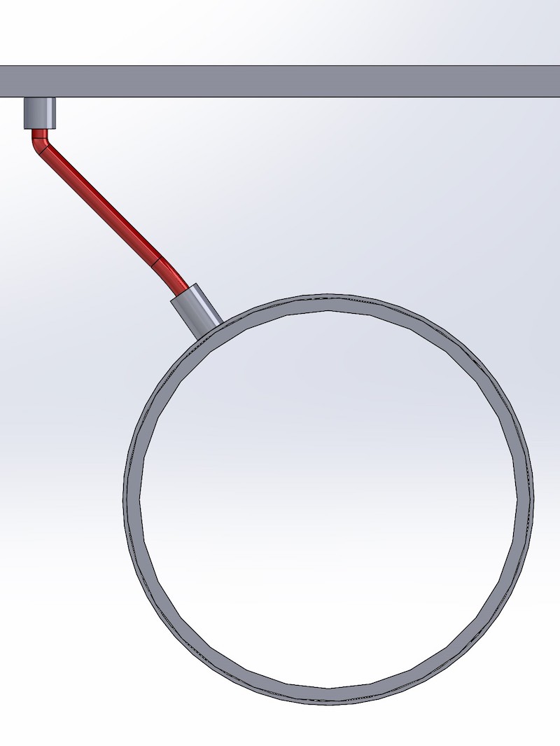

Bent piping rod hanger lateral loads. Courtesy: Matrix Technologies Inc.

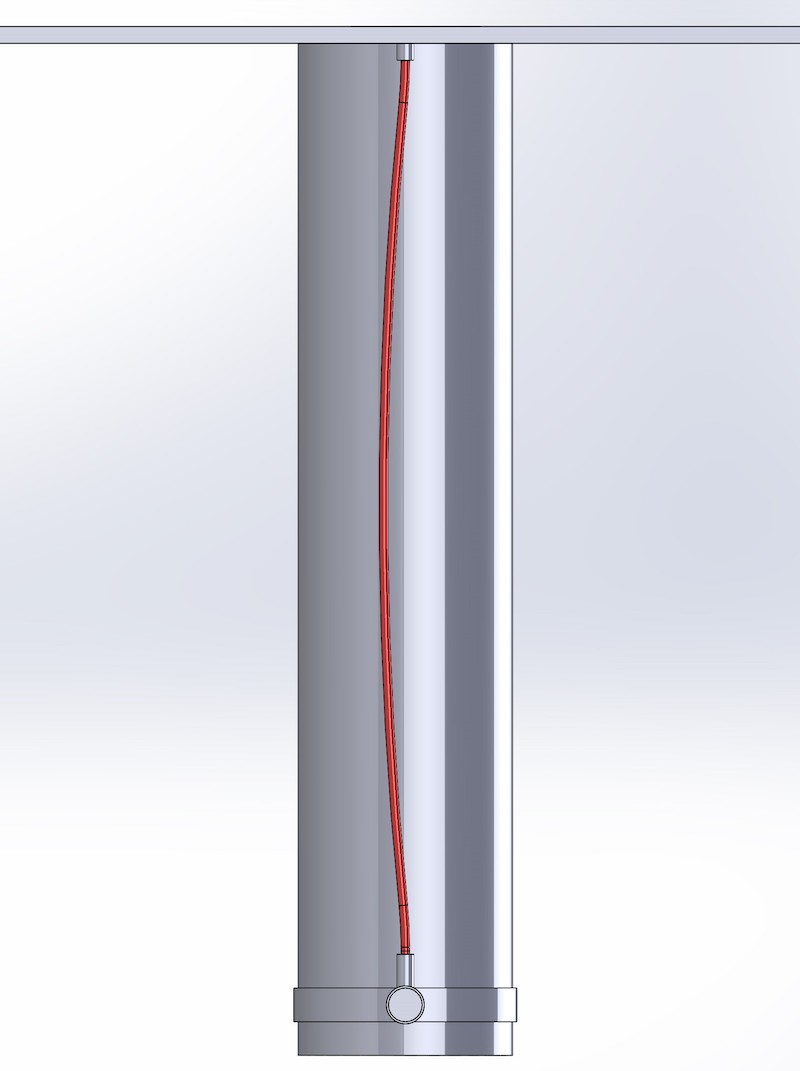

Bent piping rod hanger vertical load. Courtesy: Matrix Technologies Inc.

Bent support steel or rod hangers: While it’s not uncommon to see rod hangers that are somewhat tilted, a rod that’s obviously bent or with a large rotation could point to thermal growth problems that need to be addressed. Bowed rods can also point to piping that has grown in unexpected directions.
