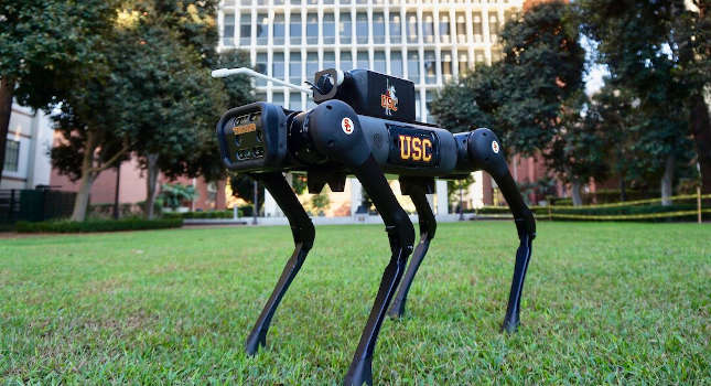

There are so many things robots can do on wheels, but in narrower, shallower spaces—like between desks in a classroom or on a stairwell—wheels can be limiting. Enter LASER-D (Legged Agile Smart Efficient Robot for Disinfection ) a four-legged robot created by a team of USC researchers at the USC Viterbi School of Engineering. The animal-like LASER-D combines—for the first time—locomotive agility and chemical disinfection to fight COVID-19, among other applications.
Led by USC Viterbi professors SK Gupta and Quan Nguyen, the team worked to create LASER-D—built on an earlier project, a UV disinfection robot, and adapted Nguyen’s legged robot platform.
“This is the first time we’ve combined a legged robot with the disinfection task,” said Nguyen, an assistant professor of aerospace and mechanical engineering. This can be challenging, because we need to maintain mobility while positioning for disinfection. LASER-D conserves energy by walking and positioning its body simultaneously. Thus, we can just use the robot orientation to control the spraying of disinfectant, instead of attaching an extra arm to perform this task,” Nguyen said.
