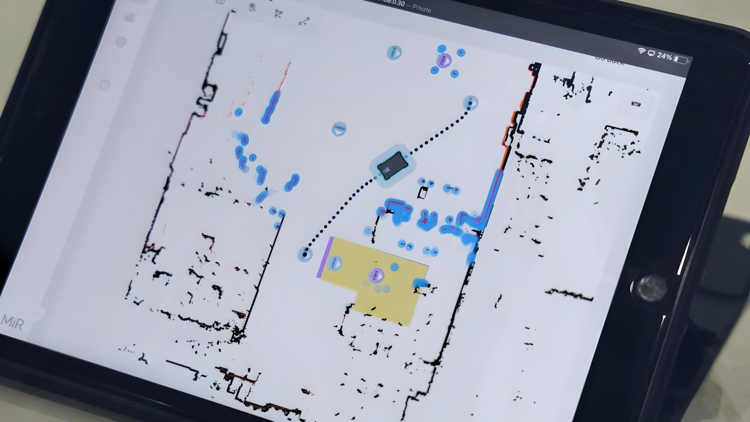

Figure 1: MiR's fleet manager software illustrates advanced navigation and fleet coordination for autonomous mobile robots. Courtesy: Applied Manufacturing Technologies (AMT)
Figure 1: MiR’s fleet manager software illustrates advanced navigation and fleet coordination for autonomous mobile robots. Courtesy: Applied Manufacturing Technologies (AMT)

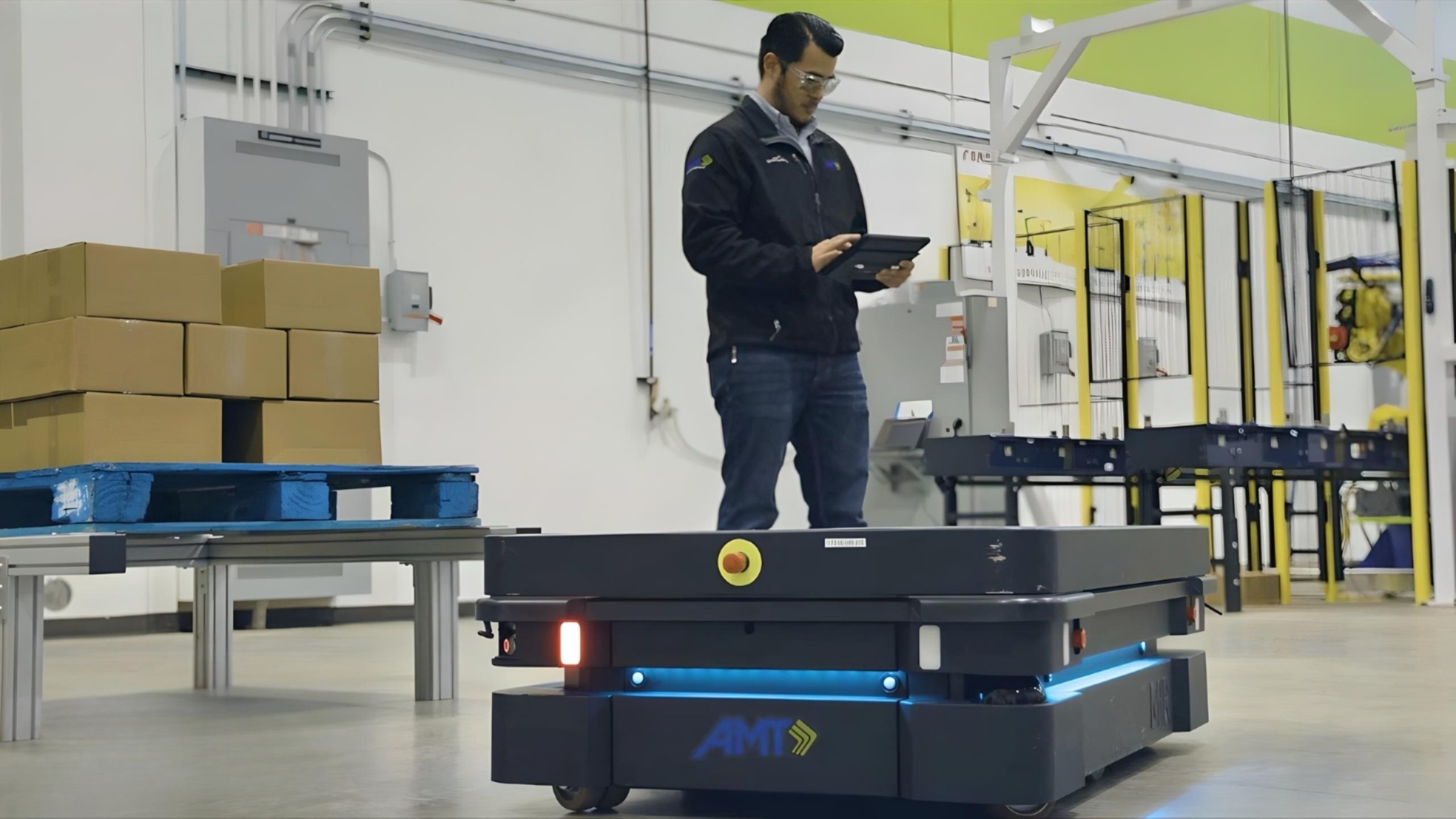

Figure 2: An engineer supervises the operation of MiR's autonomous mobile robot, designed for efficient material handling in industrial environments. Courtesy: Applied Manufacturing Technologies (AMT)
Figure 2: An engineer supervises the operation of MiR’s autonomous mobile robot, designed for efficient material handling in industrial environments. Courtesy: Applied Manufacturing Technologies (AMT)

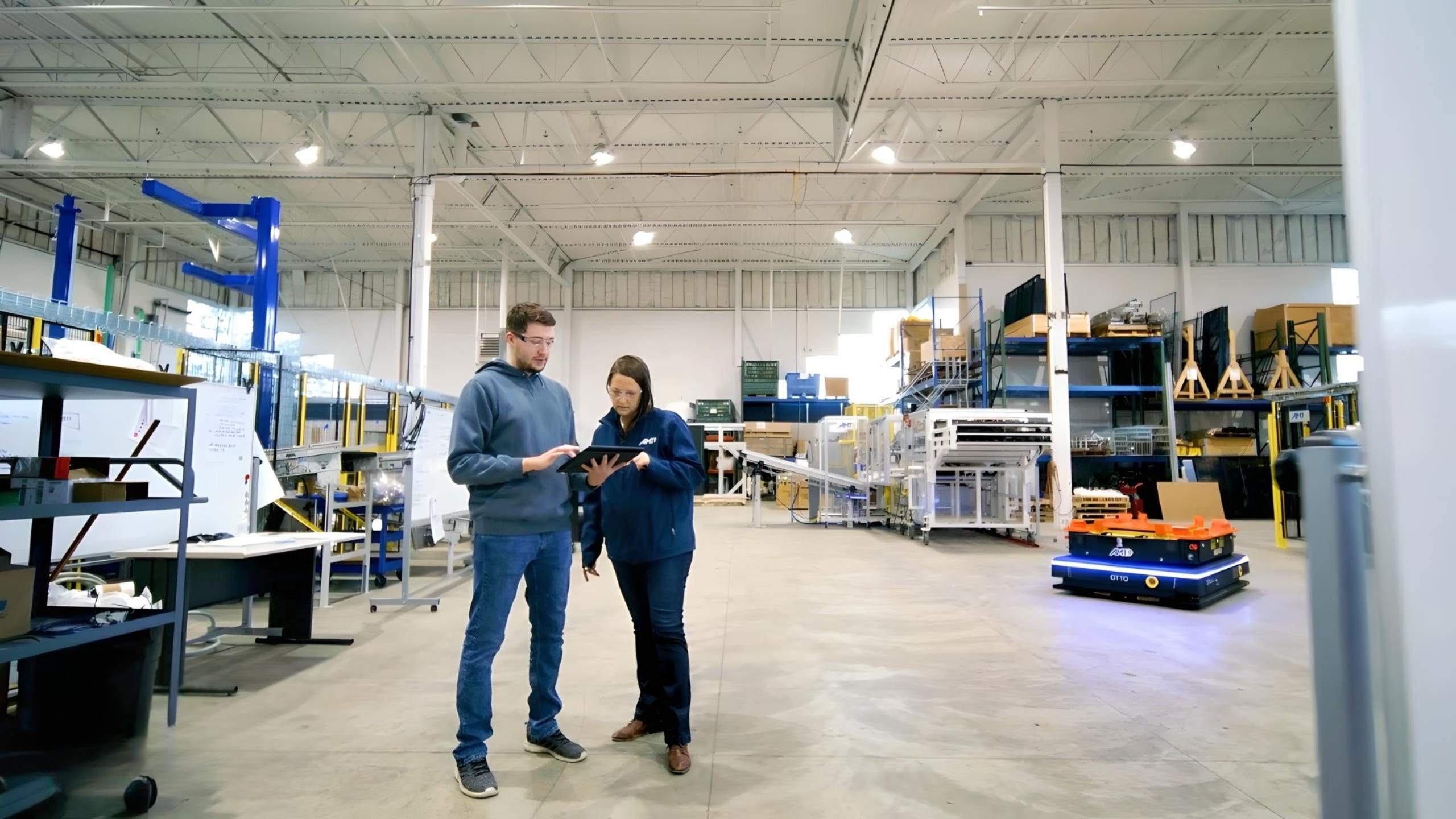

Figure 4: Engineers collaborate using OTTO Motors' autonomous mobile robot in a warehouse setting, highlighting the integration of advanced robotics into industrial workflows. Courtesy: Applied Manufacturing Technologies (AMT)
Figure 4: Engineers collaborate using OTTO Motors’ autonomous mobile robot in a warehouse setting, highlighting the integration of advanced robotics into industrial workflows. Courtesy: Applied Manufacturing Technologies (AMT)
