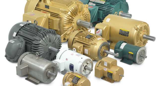

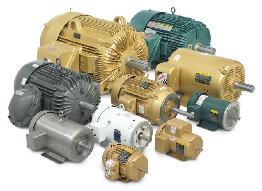

The most obvious mechanical difference is that NEMA motors are defined in inch units and IEC are defined in metric units. Beyond that, NEMA motors offer a wider range of motor enclosures not common in the IEC designs such as open-drip proof motors used in many compressor and fan applications (see Figure 1).
Figure 1: NEMA motors offer a wide range of enclosures such as open-drip proof (ODP) motors used in many compressor and fan applications. NEMA motors are defined in inch units and are made with the finned cast frames and rolled steel frame housings. Courtesy: ABB Motors and Mechanical

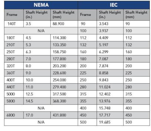

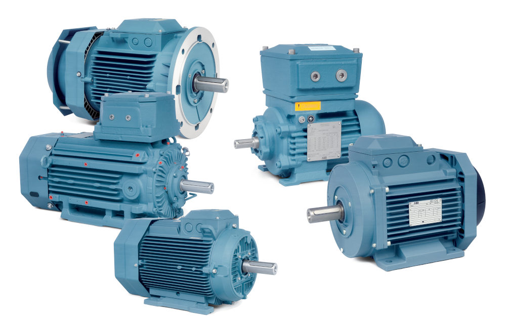

IEC motors are commonly made with either finned cast aluminum or iron frames, while NEMA motors are made with the finned cast frames and rolled steel frame housings (see Figure 2). There are only slight differences in frame sizes based on shaft height (see Table 1). The shaft diameters and lengths are different between NEMA and IEC as are the mounting base dimensions and mounting hole spacing.
Figure 2: IEC motors are commonly made with either finned cast aluminum or iron frames and are defined in metric units. Courtesy: ABB Motors and Mechanical

Table 1: NEMA versus IEC shaft heights

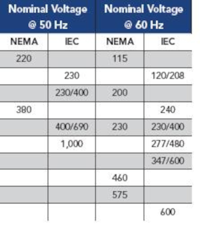

The 3-phase 60 Hz motors used in North America are usually 230/460 V with a 9-lead 1-wye/2-wye connec­tion. An IEC motor at 4 kW and larger have wye/delta connections for 230/400 volts where they start in a wye/ delta manner, not direct across the line (see Table 2).
The difference between NEMA and IEC is not the voltage/frequency combinations, but the tolerance each standard places on these parameters. The maximum voltage variation allowed by NEMA is ±10% at rated fre­quency, while the maximum allowable frequency varia­tion is ±5% at rated voltage. IEC separates motors into operating zones where a zone A motor shall be capable of performing its primary function with a voltage within ±5% of rated and a frequency within ±2% of rated. IEC also recognizes zone B, which allows a voltage variation of ±10% and a frequency variation of +3%, -5%.

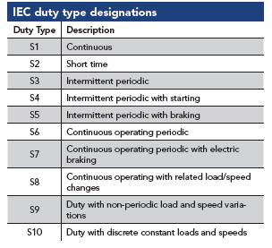

Most NEMA motors have a continuous duty cycle. NEMA also defines intermittent duty motors for some applications with 15-minute, 30-minute and 1-hour duty cycles. This means the length of time for the motor to operate at full load before reaching maximum safe operating temperature, then the motor must cool to ambient before it is operated again. IEC has a more elaborate duty cycle rating system that also includes cyclic loads, but the S1 is the normal continuous duty cycle on most motor designs. IEC 60034-1 goes into more detail on the definitions of these duty cycles with illustrative charts.
IEC duty type designation.

Table 2: Voltage and frequency combinations
