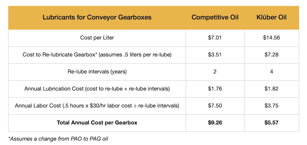

More opportunities on savings are on components that are difficult-to-reach or that require equipment shut down for lubrication routines, such as chains, open gears and manually lubricated bearings. Additional labor reduction and improved equipment reliability can be achieved when single point lubricators (also known as SPL or autolubers) are installed to replace manual lubrication. SPLs change frequent manual relubrication activities and possible equipment shutdown, by extended lubrication service supported by quick visual inspections. Optimum results are obtained when the best lubricant for the application is combined with the right SPL for that application.
Table 2: Cost analysis of lubricants for conveyor bearings for oil.
Table 2: Cost analysis of lubricants for conveyor bearings for oil. Courtesy: Klüber Lubrication NA

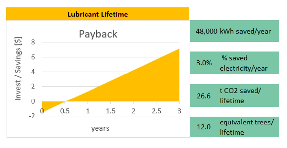

Performing a lubricant change focused to save energy (or energy efficiency) is a streamlined process. It starts by measuring the energy consumption of a machine for a period and estimating the energy savings potential. After the oil has been changed a new measurement is performed for a similar period and compared to the original conditions.
Figure 1: Return on investment (ROI) using lubricants.
Figure 1: Return on investment (ROI) using lubricants. Courtesy: Klüber Lubrication NA
The difference is calculated considering equipment load. Below is an example of a case study of energy savings and payback period resulting of replacing a conventional oil with a fully synthetic lubricant in the gearbox of a cement mill. This principle is applicable to other machines in diverse industries.

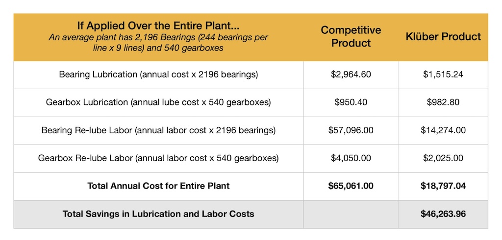

Table 3: Cost analysis of lubricants for conveyor bearings for an entire plant.
Table 3: Cost analysis of lubricants for conveyor bearings for an entire plant. Courtesy: Klüber Lubrication NA
Lubricants on the production line affect the bottom line
In order to avoid the pitfalls of purchasing lubricants based solely on price, evaluate the current program and then request a comparative cost benefit analysis from a potential supplier. Simple calculations can reveal significant savings that aren’t always evident in the initial cost of a lubricant. The numbers tell the story.
