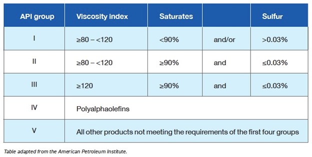

API Group I base stocks have less than 90% saturates, i.e., more than 10% unsaturates. If the base stock contains more than 0.03% sulfur, it would be categorized as a Group I base stock, also. Finally, the base stocks viscosity index (VI) must be greater than or equal to 80 and less than 120. API Group I base stocks are the product of solvent refining introduced in the 1930s.
API Group II base stocks have 90% or more saturates and less than or equal to 0.03% sulfur. The VI must be greater than or equal to 80 and less than 120, just like API Group I. API Group II base stocks may be produced by hydrocracking and catalytic dewaxing to remove the impurities.
API Group III base stocks have 90% or more saturates and less than or equal to 0.03% sulfur, similar to Group II, but has a VI greater than or equal to 120. API Group III base stocks are manufactured utilizing hydrocracking, catalytic dewaxing and hydrotreating to remove impurities and raise the VI.
API Group I and II are considered mineral oils. API Group III may be called synthetic oil by some companies because of the synthetic-like performance. Others call it mineral oil because it is refined from crude oil.
API Group IV base stocks are polyalphaolefin (PAO) synthetic oils with a VI range of 125-200. These base stocks are synthesized versus refined from crude oil.
API Group V base stocks are any other base stock not covered by API Groups I, II, III or IV, such as naphthenic oils, esters, polyglycols, silicones, biolubes and halogenated fluids. If a fluid is a synthetic fluid but is not a PAO, it would be an API Group V base stock (see Table 1).
Table 1. API base oil classifications. Courtesy: STLE
