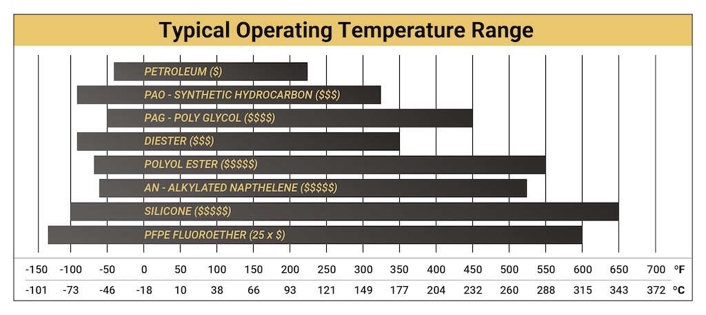

Polyalphaolefin- (PAO) based synthetic lubricants have found broad acceptance in transportation applications due to their high and low temperature abilities, but by looking at the chart, it is clear it will no longer be the base fluid of choice above 300 °F. One of the major culprits hindering proper high temperature chain lubrication is residue created as the lubricating fluid thermally degrades under the oxidative stress of the hot environment. Not only will PAOs start to degrade as temperatures rise, but the hard carbonaceous residue left behind will block lubricant passageways and can itself cause wear. Due to PAO’s non-polar nature, it also lacks the self-solubilizing attribute of some of the more polar molecules found in base fluids for higher temperature applications.
As temperatures rise above 400 °F, engineers will find greater use of synthetic fluids with more polar molecules such as polyalkylene glycols (PAGs) and polyol esters (POEs). These fluids provide cleaner performance and withstand higher temperatures for longer times before thermally degrading. PAGs leave little or no residue but can generate some undesirable smoke as temperatures rise near 500 °F. The other synthetic fluids listed have niche applications, but may show weaknesses in either wear protection or deposit control.
Figure 1: Typical best temperature ranges for base fluids in fully additized finished formulations for extreme environments. Note: Silicone and PFPE fluids are not soluble with most additives and may exhibit unacceptable levels of wear.
Figure 1: Typical best temperature ranges for base fluids in fully additized finished formulations for extreme environments. Note: Silicone and PFPE fluids are not soluble with most additives and may exhibit unacceptable levels of wear. Courtesy: JAX Inc.

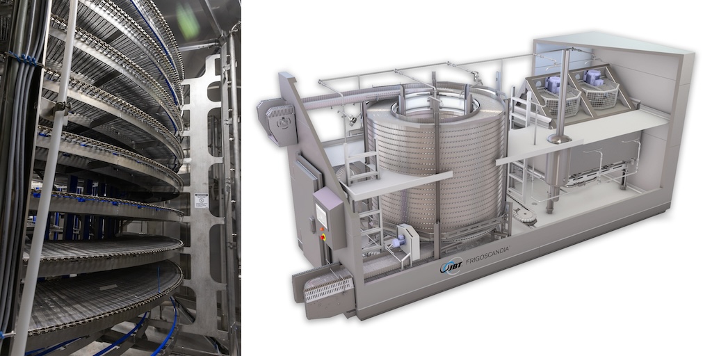

Most low temperature industrial chains and conveyors are found in food processing environments. These applications are often far below the -40 °F range where conventional mineral based lubricants will function. Freezing methods in food production are continuous processes. Production lines for small pieces like cut fruit and vegetables, or small bits of protein are air driven freezing tunnels having no need for conveyor systems. The fan driven cryogenic air moves the product. As product size and weight increase this is not possible. Straight line conveyors may be used, but the typical freezing method is the cryogenic spiral freezer.
In this machinery, the chain is not driving the rotation. While it is performed by a gear box, but the chain is supporting the product conveying medium. Here is where PAOs outshine most other synthetic base fluids because they are suitable for H1 food grade applications and also are one of the best-performing synthetic fluids at extremely low temperatures in terms of flow. In extreme low temperature applications, a balance must be struck between viscosity and antiwear performance.
In the range of -70 to -90 °F, lubricant flow becomes a critical factor. Freezing equipment original equipment manufacturers (OEMs) and processors are seeking to push the envelope to lower process temperatures. Product freezing can be nearly doubled with every 15 °F drop in process temperature.
Adding to the lubrication complications, these units also will undergo a clean-in-place (CIP) sanitization process. This involves chemical cleaning at ambient temperatures or above, which means the lubricant also must provide adequate wear and corrosion protection for the equipment before, during and after the CIP process.
Figure 2: Extreme low temperature spiral freezer.
Figure 2: Extreme low temperature spiral freezer. Courtesy: JBT-FrigoScandia Division

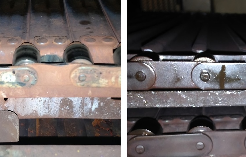

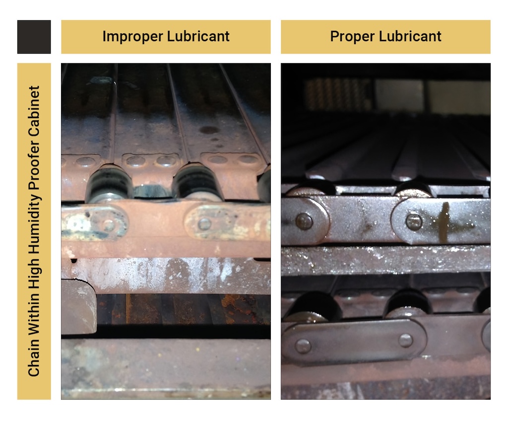

Bakery proofer chains see a very high humidity environment for extended periods.  Temperatures are not the aggressive factor, but the environment and presence of particulates present challenges for the lubricant to protect against rust and abrasive wear.
Figure 3: Comparison of a bakery proofer line chain prior to using a properly additized lubricant for its environment (left) and its condition after using a properly additized lubricant (right).
Figure 3: Comparison of a bakery proofer line chain prior to using a properly additized lubricant for its environment (left) and its condition after using a properly additized lubricant (right). Courtesy: JAX Inc.

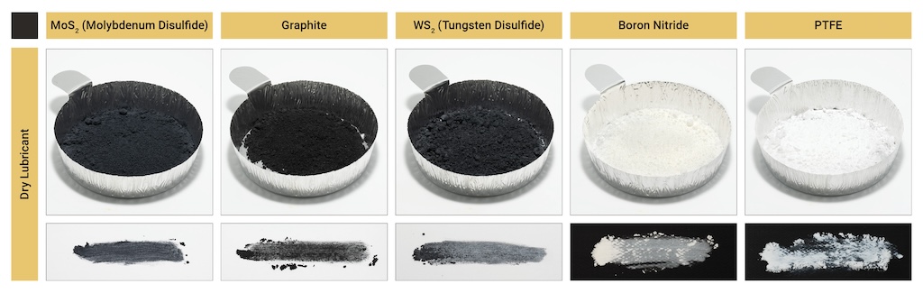

In areas so hot that rapid degradation or fire risk makes fluid lubrication impossible, the lubrication of chain systems can sometimes fall to solid lubricants. The solid lubricant is typically applied as a suspension or mixture in a sacrificial liquid carrier. The carrier’s job is enabling the solids to flow and penetrate into the wear points and then, as cleanly as possible, disappear. Mineral spirits, alcohols, or PAGs are often favorite carrier fluids due to their relatively clean evaporation or quick flash off characteristics.
Although dry film lubricants can exhibit some exceptional friction reduction and high temperature capabilities, like fluid lubricants they will need to be reapplied on a regular interval. One consideration is solids may not dissipate. They can accumulate, causing lube passageways to clog and chain surfaces to become caked. In the instance of bakery chains lubricated with water or solvent based graphite, the chains will have to be beaten with hammers each week or blasted with dry ice to remove excess graphite accumulation.
Most dry lubricants also optimally function in an air-free vacuum environment. Even though they can be efficient in reducing friction in many industrial applications, their effectiveness can be adversely affected by humidity, air, water and impurity levels in the environment.
Their relative performance also can be altered by the particle size and purity of the solid film lubricant itself. Different solid film lubricants also will function at varying performance levels depending on their level of affinity for the lubricated substrate material.
Figure 4: Common solid film lubricants used in extreme condition chain and conveyor lubricants. Pictured in dry form, but typically applied as a dispersion in a fluid carrier.
Figure 4: Common solid film lubricants used in extreme condition chain and conveyor lubricants. Pictured in dry form, but typically applied as a dispersion in a fluid carrier. Courtesy: JAX Inc.
