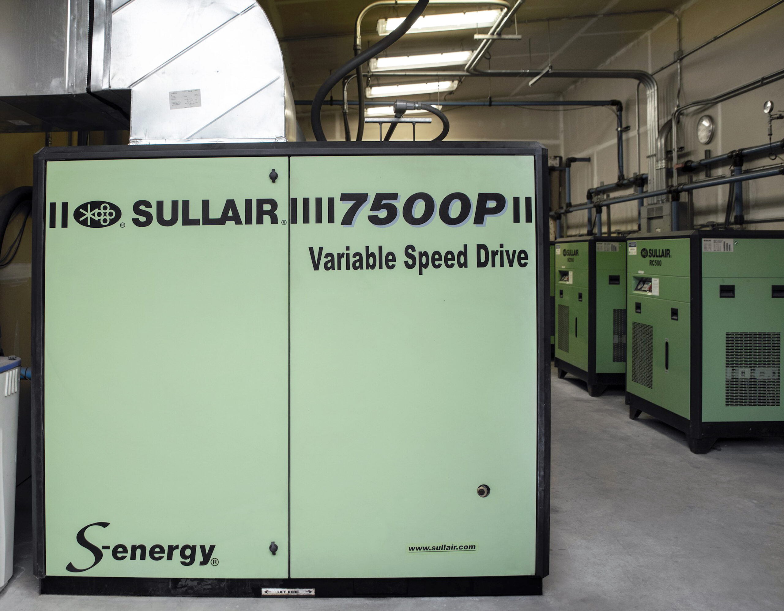

Maintenance begins before installation
While it might seem counterintuitive, a top-flight maintenance program begins long before the compressor comes through the door. Choosing the right machine and determining its ideal location will impact a compressor’s performance.

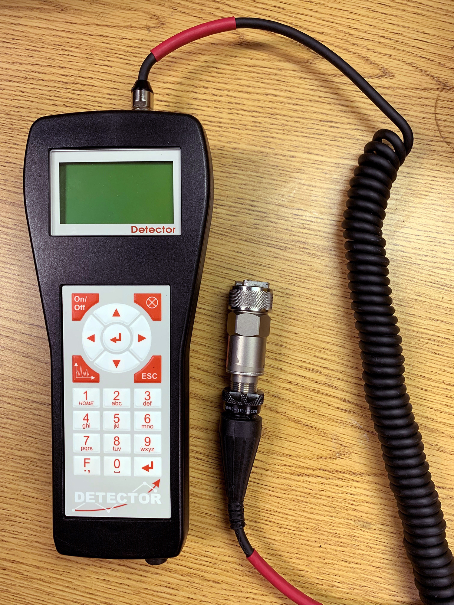

Figure 1: Vibration analysis is one predictive maintenance tool to monitor the health of rotary screw air compressors. It is best to record a baseline vibration profile soon after the compressor is installed. Courtesy: Hitachi Global Air Power
Size is a critical first step; simply put, users need to select the right compressor for the job. An undersized compressor can overtax the machine and shorten its lifespan. Similarly, a compressor too large for the operation — even if accounting for future growth — may be less efficient. An air audit by a certified professional can help you determine the correct capacity for the operation.
Location also matters. The operating environment plays a critical role in compressor maintenance. Do you operate in the scorching southwestern deserts or are you located in the often-frigid northern states? Is a facility sited in an arid climate or one where rain or snowfall are measured in feet, not inches? Does the facility generate significant dust and particulates, such as found in paper mills, or do you operate a pristine pharmaceutical operation?
All these location factors will play a role in maintenance processes and schedule. As you can guess, the dirtier the environment, the more frequent service calls need to be and the more vigilant you need to be tracking filter and cooler cleanliness.

Once a compressor is installed, predictive maintenance becomes key. This involves establishing a baseline for the compressor’s fluid and vibration profiles.
Vibration analysis tests and tracks a compressor’s optimum vibrations. Every compressor has a unique vibration signature and identifying that signature when first installed provides a baseline for the life of the compressor. Over time, if excessive vibration or other deviations from the machine’s normal profile are detected, potential problems which can shorten the lifespan of the compressor may be brewing.

Higher vibrations, for example, can be traced to failing bearings or gears or a decaying rolling element.. Higher vibrations can also be traced to misalignment, motor faults, mechanical looseness or broken motor mounts.
Ideally, a baseline vibration measurement should be recorded within the first few weeks or months of operation. A solid predictive maintenance program should include annual vibration measurements.
