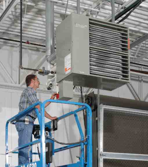

A third approach that is widely used in spot industrial applications is unit heaters. These are compact high output units using gas heating with high-velocity air distribution by either propeller or centrifugal fans. Unit heaters are a common solution near high heat-loss areas such as loading docks or openings to unheated warehouse space.
Unit Heaters for Spot Comfort
Unit heaters are available in either direct-fired or indirect-fired styles. For maximum operating efficiency with indirect firing, Modine Manufacturing offers its Effinity93 Model PTC which features a four-pass heat exchanger. The final pass is a condensing coil to extract the maximum heat from the combustion gases. Units are available in sizes from 55,000 to 310,000 BTU/hr — all operating at 93% efficiency. Because it is a condensing unit, it is necessary to pipe condensate to a plant drain.
