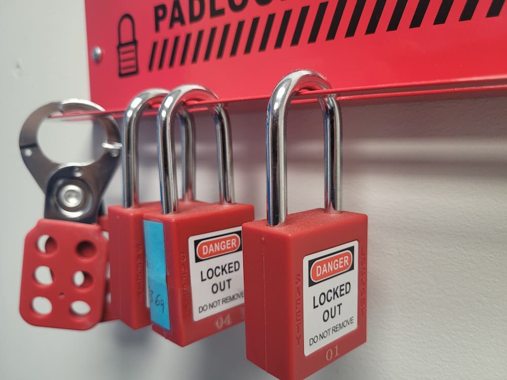

Figure 1: Example of a lockout procedure in a test lab for safety controls. Courtesy: Hedgehog Technologies
Electrical incidents can also lead to other modes of injury, including falls, especially if an incident occurs while working at heights. Given the severity of the injuries that can be sustained during electrical incidents, it is critical for firms to implement risk mitigations and for workers to practice safe work procedures to reduce the likelihood and severity of harm.

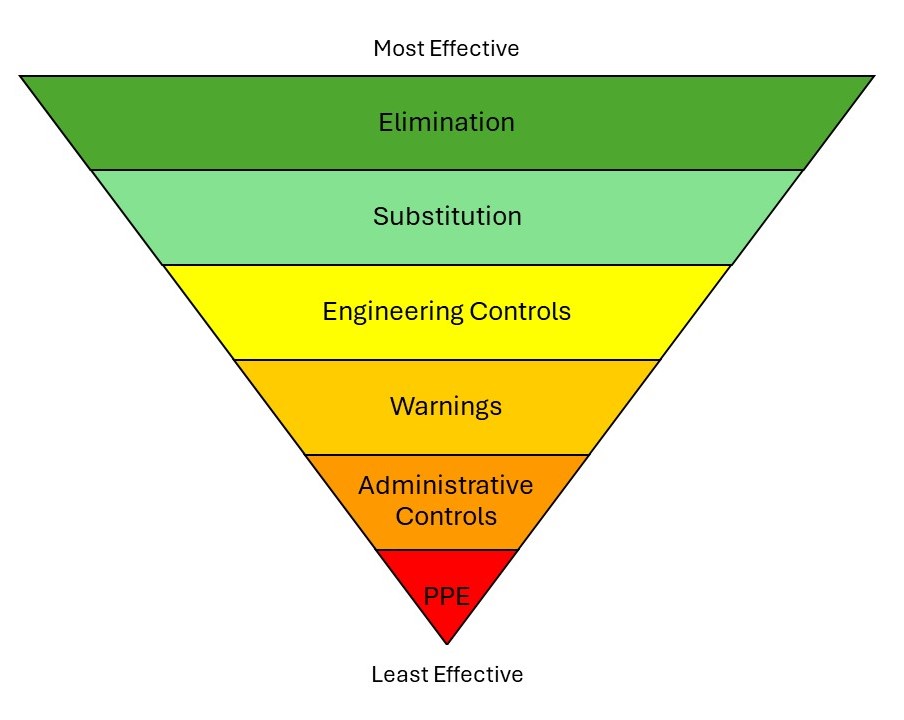

The hierarchy of electrical hazard controls
This article delves into the hierarchy of controls model used in CSA Standard Z462:21: Workplace Electrical Safety and NFPA 70E: Standard for Electrical Safety in the Workplace. This model recognizes six categories of hazard mitigation strategies, which are ranked according to effectiveness.
  • Elimination: The most effective measure is elimination, which removes the existence of a hazard in the workplace.
  • Substitution: Substitution replaces the hazard with a less severe or more manageable condition.
    Engineering controls: Engineering controls aim to isolate the worker from hazards through the design of the plant, equipment or process they interact with.
    Warnings: Warnings are designed to indicate the presence of hazards that remain after the first three mitigation approaches are applied.
    Administrative controls: Administrative controls are procedures designed to encourage safe work practices.
    Personal protective equipment (PPE): The last line of defense is PPE, which refers to items worn by personnel to protect them from workplace hazards.
A well-designed safety program will address hazards with the highest practical control level in the hierarchy and may use a combination of controls to address a single hazard.

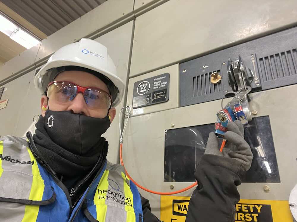

Figure 3: Engineer in front of a lockout/tag out wall. Courtesy: Hedgehog Technologies
CSA Z462:21 recognizes the importance of inspecting and maintaining engineering controls to uphold their effectiveness. Some controls, such as equipment doors, may require removal during plant operations and must be replaced to restore the effectiveness of this mitigation scheme. Others, such as ground fault detection devices, may fail unexpectedly and should be regularly tested by plant personnel. An electrical safety program should include procedures for inspecting and maintaining electrical equipment.

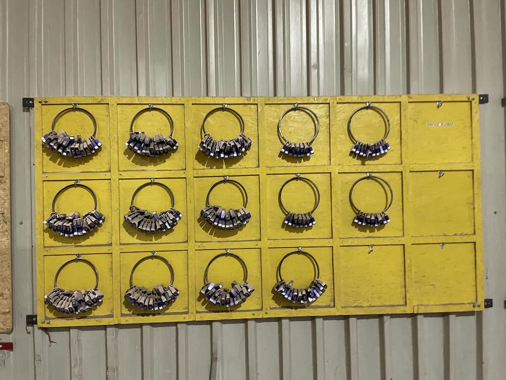

Two key administrative controls are the plant’s live work and lockout policies. CSA Z462 requires that electrical equipment is de-energized before a worker enters the limited approach boundary unless de-energization is infeasible or would introduce additional hazards. The standard also mandates firms to create a lockout policy and provide lockout training to their employees at three-year intervals.

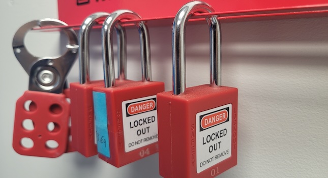

The objective of a lockout is to securely isolate a piece of equipment from sources of energy while work is being performed. An energy-isolating device, such as a circuit breaker or disconnect switch (in the case of electrical energy), is operated and an individually-keyed lock is applied to prevent the reenergization of the equipment until it is safe to do so. The equipment is then tested to ensure that the isolation is effective – switching mechanisms can fail and equipment may be energized even when a disconnect is in the “off” position. Additionally, testing may reveal that the equipment is fed from different (or multiple) sources that were not anticipated by the worker. Workers should also be aware of the hazards of stored energy, including energy stored in capacitors, the insulation of high voltage cables, hydraulics, pneumatics, suspended parts, springs and other sources.
Figure 4: Close-up of lockout/tag out display. Courtesy: Hedgehog Technologies
An important but often neglected component of an administrative control is the documentation of a plant’s electrical systems. Accurate documentation will help workers identify sources of energy and devices that can be used to isolate equipment. However, workers should not assume that the plant’s documentation is accurate. Industrial plants are dynamic workplaces and documentation becomes outdated quickly if not maintained.

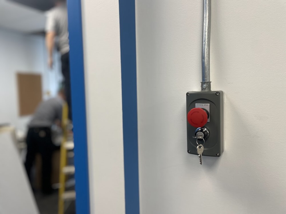

Figure 5: View of an emergency stop button in a testing lab. Courtesy: Hedgehog Technologies
Six categories of hazard control strategies can be implemented in a firm’s electrical safety plan. Priority should be given to removing, reducing and guarding workers from a hazard, but warnings, safe work procedures and PPE are often needed to manage residual risk. Standards like CSA Z462:21 and NFPA 70E are based on this hierarchy and provide guidance for developing a robust electrical safety program.
