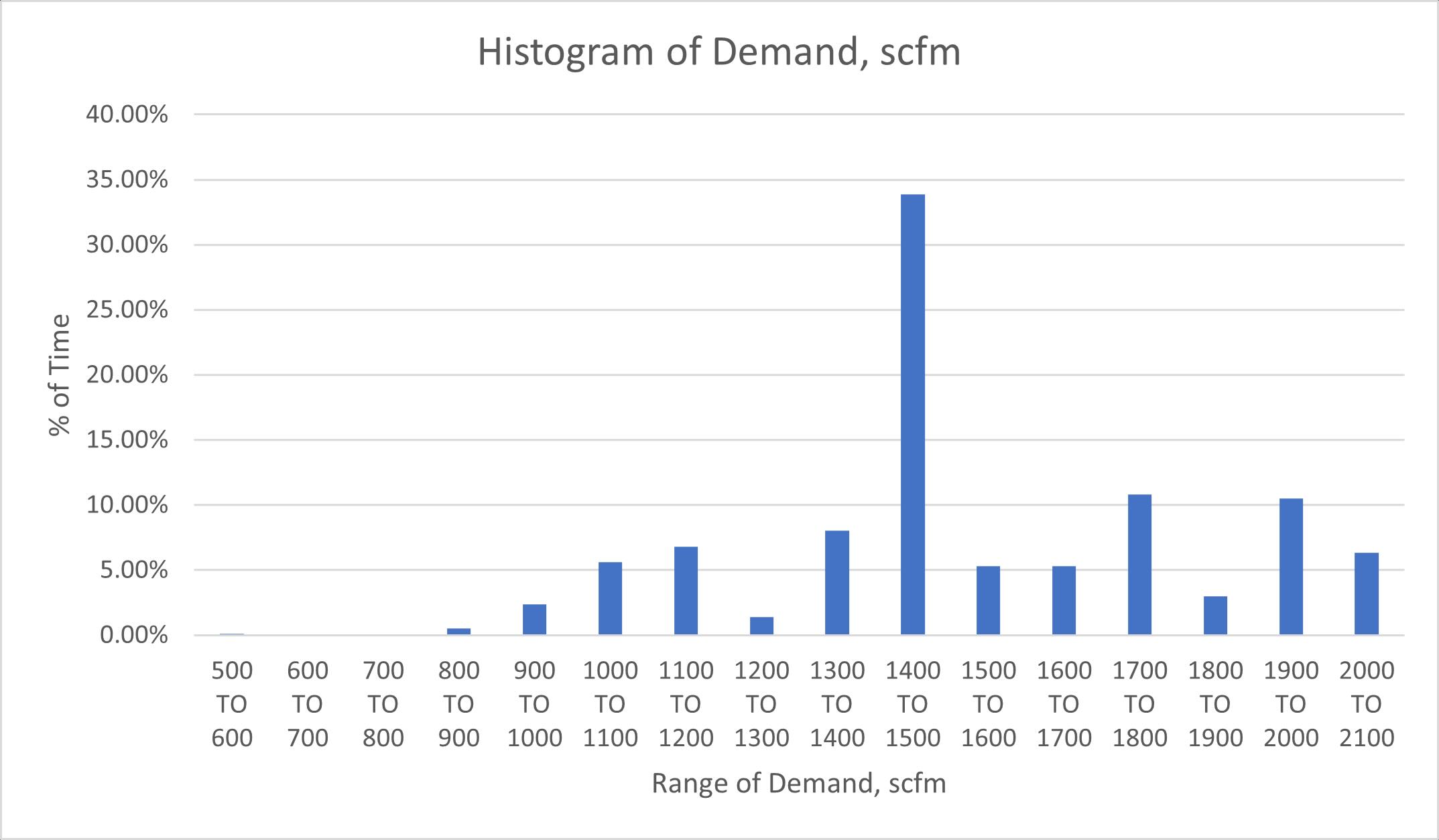

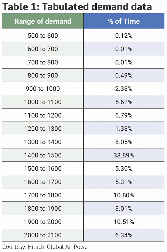

Consider the application illustrated in Figure 1. The peak demand for the facility is between 2,000 and 2,100 standard cubic feet per minute (scfm) and occurs 6.34% of the time. The compressed air system must be capable of meeting this demand. If this were an intermittent demand, the application of controlled storage would be appropriate. In this case, the demand is sustained, and the system must be capable of regularly generating the stated capacity.
Figure 1: Histogram of demand.
Figure 1: Histogram of demand. Courtesy: Hitachi Global Air Power
The application engineer must also consider the other ranges of demand because the plant operates at other demand levels for much of the time. Specifically, the range of 1,400 to 1,500 scfm must be given priority as the plant operates in that range of demand about one-third of the time, or 56 hours per week.

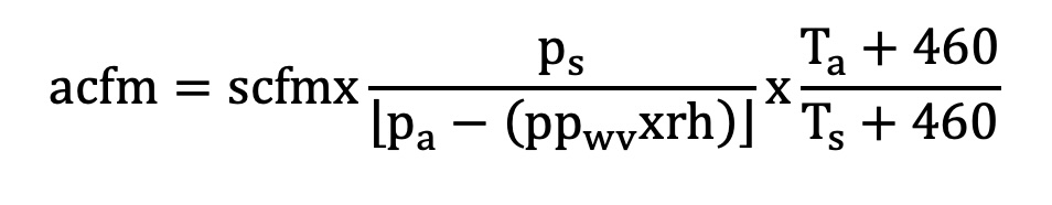

The demand data provided in this example is shown in scfm, while the compressor capacity data is shown in acfm. The demand and capacity information must be expressed in consistent terms so the compressors can be properly sized. For this example, the demand data will be converted to acfm.
In many applications, the end user will stipulate the compressed air system must always provide a defined capacity at the specified pressure and air purity. Often, the capacity is expressed as scfm, and the design conditions (extreme summer and winter) are provided.
In the case of a rotary screw air compressor, the combined effects of altitude, temperature and humidity present in summer conditions result in the de-rating of the compressor capacity when the capacity is expressed as scfm instead of acfm. The relationship between acfm and scfm is provided below.

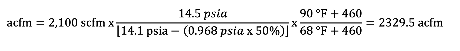

  • For this application, the specified site summer conditions are as follows:
  • 1250 ft above sea level (14.1 psia atmospheric pressure)
  • 90 °F (0.698 psia, not corrected for altitude)
  • 60% relative humidity
Substituting values into the equation:

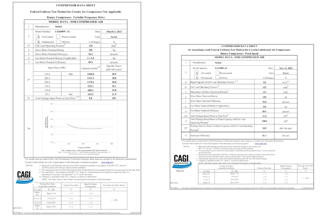

The CAGI data sheet shown in Figure 2 illustrates the full-load capacity of the compressor as 1,660 acfm @ 125 psig. Also note its turndown range is 1,225 acfm (1,660 acfm at full load – 435 acfm at minimum flow). A base load compressor complementing the trim compressor that provides a minimum capacity of 669 acfm is needed so the compressor meets the total demand required by the plant.
Figure 2: This combination of compressors meets the identified criteria; the total capacity matches the required system capacity (when adjusted for summer operating conditions), and the turn down capacity of the variable speed compressor exceeds the capacity of the fixed speed compressor, so that the potential for control gap is mitigated.
Figure 2: This combination of compressors meets the identified criteria; the total capacity matches the required system capacity (when adjusted for summer operating conditions), and the turn down capacity of the variable speed compressor exceeds the capacity of the fixed speed compressor, so that the potential for control gap is mitigated. Courtesy: Hitachi Global Air Power

Another point of interest is the efficiency of the VSD controlled compressor (CAGI data sheet on the left). At the 1,500 to 1,600 scfm demand level (corrected to 1663 acfm for summer conditions) the VSD compressor is very near full load, representing an efficient operating point. Below this point, the VSD compressor will be on its control curve, where the specific power begins to increase (less efficient). However, the increase in package specific power is reasonable, such that at minimum flow, the specific power is 21.9 kW/100 cfm. What happens when the demand exceeds the capacity of the VSD controlled compressor? The fixed speed compressor comes on-line, and operates at full load, contributing its capacity to the plant demand. The VSD compressor output falls to 958 acfm, as it is reduced by an amount equal to the capacity of the fixed speed compressor (702 acfm). The reduced output of the VSD air compressor falls at a location on the control curve slightly more efficient than the full load specific power for the compressor.
In this scenario, the capacity of the back-up air compressor would need to be equivalent to the VSD controlled compressor, as it is the largest in the system.

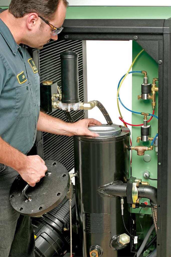

One last thought about sizing a compressor, or more appropriately, about selecting a compressor. An industrial air compressor, if properly maintained, should last ten years or more. Often, the compressor distributor will provide maintenance and service for the life of the compressor (and the associated equipment).
Considering the capabilities of the service provider is an important part of the selection process. It is so important the Compressed Air Challenge Best Practices for Compressed Air Systems includes an entire chapter on the topic, “Guidelines for Selecting a Compressed Air System Service Provider.” A trusted service team can ensure the perfectly sized compressed air system performs optimally.
Image 2: Maintenance is critical to keeping your right-sized compressed air system running optimally.
Image 2: Maintenance is critical to keeping your right-sized compressed air system running optimally. Courtesy: Hitachi Global Air Power
In the end, many factors should be considered when sizing a compressed air system, not just capacity and pressure. Properly analyzing all variables – VSD, base load, control gap, dryer purge, and maintenance — will result in the most efficient and reliable system for an operation.
