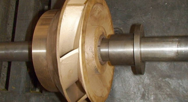

Top-down or bottom-up? Some VTPs secure impellers to the shaft with annular keys that fit into annular keyways in the shaft. The keys will be bolted to the top of the impellers, so disassembly must be from the top-down to access the annular key bolts (Figure 2).
Figure 2: An annular key mounted impeller. Courtesy: EASA
But most VTPs secure impellers to the shaft by driving tapered collets into them from the top with a collet driver. To disassemble these pumps, drive the collets up out of the impeller from the bottom with the same collet driver. Therefore, disassembly will be from the bottom-up. While it is possible to disassemble these pumps from the top-down by driving the impeller down off the collets, many service centers find this more difficult.
Figure 3: A tapered collet mounted impeller with collet driver. Courtesy: EASA
