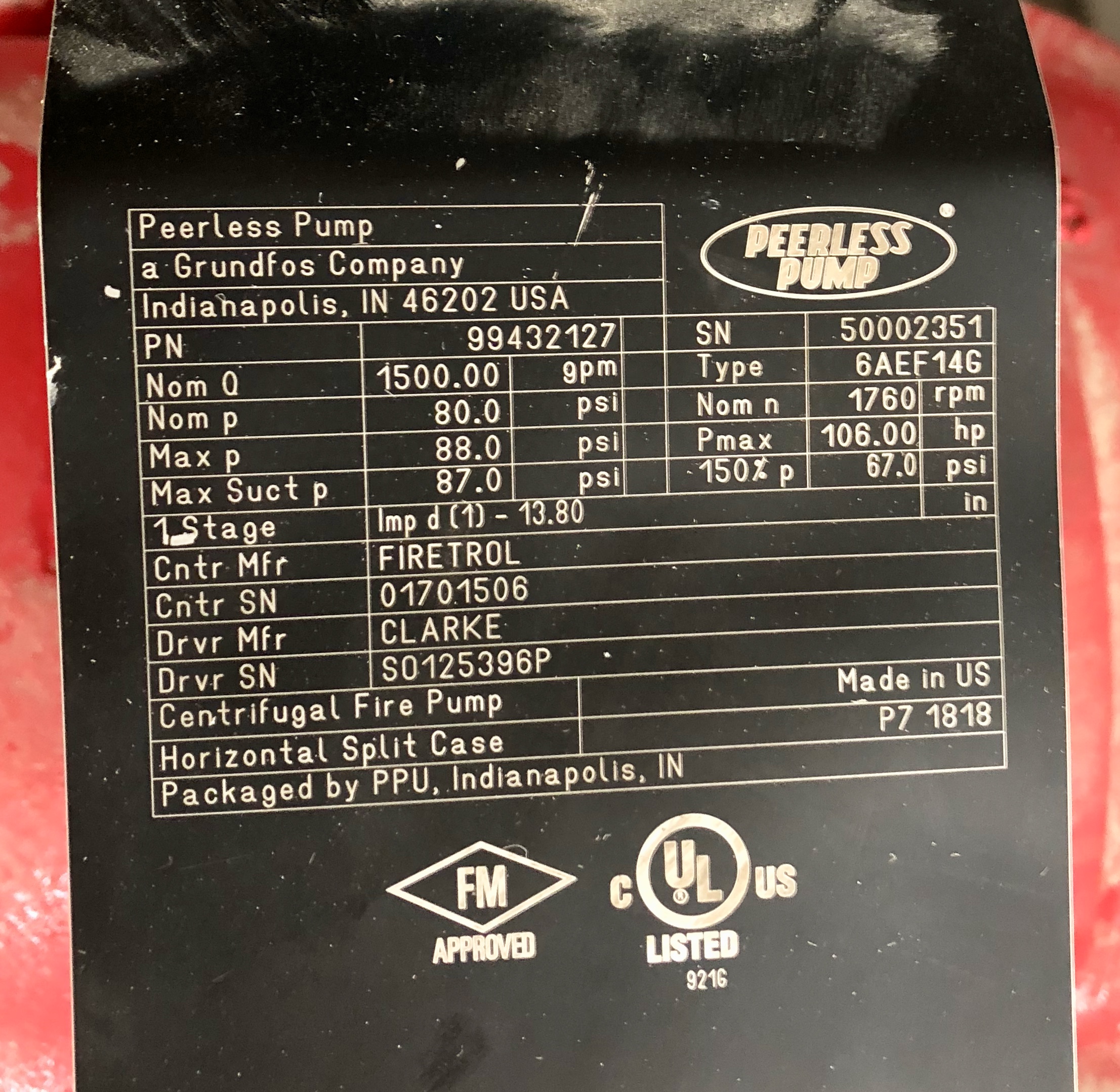

The intended pump was specified by the system designer, and pump performance in terms of flow and pressure at the rated speed was confirmed by the listing organization, marked on the pump’s nameplate (see Figure 1) and verified through acceptance testing.
Since the 2003 edition of NFPA 20, fire pumps operating at speeds less than their rating have been allowed giving the design engineer more options in meeting overall fire protection system performance objectives.
Figure 1: Fire pump nameplate. Courtesy: Milosh Puchovsky

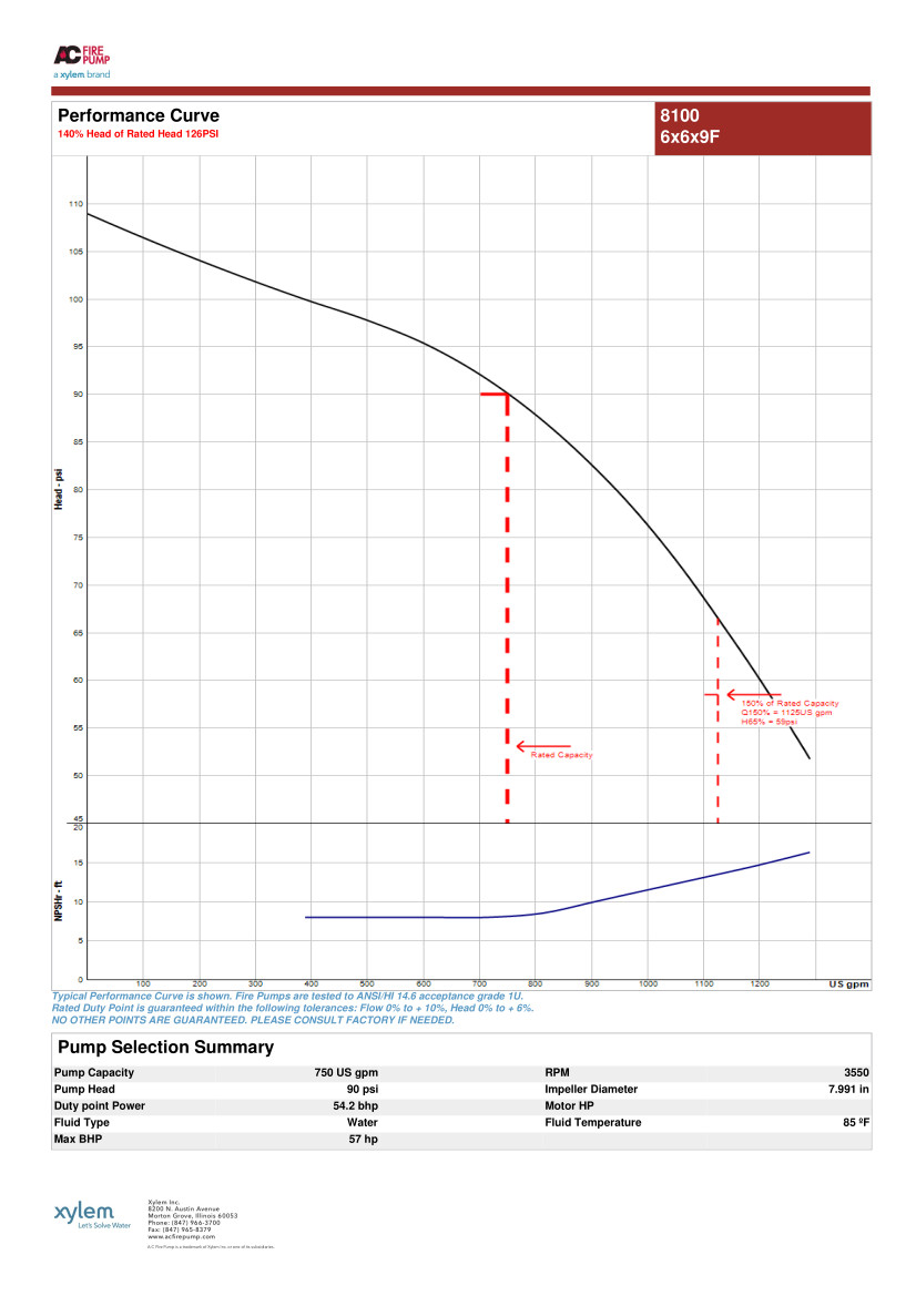

Fire pump performance curve
Centrifugal fire pumps are manufactured to operate at a specified rated speed. For example, a given 750 gallons per minute pump, as represented by the performance curve in Figure 2, will produce a net pressure of 90 pounds per square inch when operating at a speed of 3,550 revolutions per minute.
However, the pressure produced by the pump at that speed will vary depending upon the flow demand of the fire protection system. As the flow through the fire pump increases, in this case to a value greater than 750 gpm, the pump produces less pressure.
Conversely, when the fire protection system’s hydraulic demand is less than the pump’s rated flow, pressures greater than the pump’s rated pressure will be produced. The operating range in Figure 2 applies when the pump operates at its rated speed of 3,550 rpm. If the pump operated at some other speed, the performance curve would be altered.
NFPA 20 sets limits on the pressure ranges that can be produced by the pump. Pump manufacturers produce pumps that fall withing the bounds of this range. Pumps operating at a given speed develop their maximum pressure output when no water is discharged downstream of the fire pump discharge flange i.e., when no water is flowing out of the fire protection system or from a test header valve. This condition is referred to as shut-off, churn or zero flow.
Paragraph 6.2 of NFPA 20 limits maximum churn pressures to 140% of the pump’s rated pressure when the pump operates at its rated speed. Therefore, a fire pump rated at 90 psi cannot develop a churn pressure greater than 126 psi at its rated speed. Churn pressures less than the 140% limit are acceptable and would present pumps with “flatter” performance curves.
The manufacturer’s information specific to the pump in question needs to be ascertained (see Figure 2), as this would indicate the actual churn pressure for the pump as well as the rated flow, pressure and speed. The fire protection system would be exposed to churn-condition pressures on a fairly routine basis — for instance, weekly — depending on the testing frequency required by NFPA 25: Standard for the Inspection, Testing and Maintenance of Water-Based Fire Protection Systems for the specific type of pump driver. Under weekly pump tests, the discharge of water from the pump test header or through a metering device is not required.
The other end of the pump’s operating range is referred to as the overload point. NFPA 20 identifies this as 150% of the rated flow. For the 750-gpm pump in Figure 2, this would be 1,125 gpm. As noted above, when flow through the pump exceeds the rated flow, the pressure produced by the pump drops. NFPA 20 limits the pressure drop to no more than 65% of the pump’s rated pressure.
Therefore, a fire pump rated at 90 psi cannot develop an overload pressure less than 58.5 psi at its rated speed. Overload pressures greater than the 65% limit are acceptable and would also present pumps with “flatter” performance curves. Depending upon the source and characteristics of the water supply, pumps operating near their overload point could create adverse suction conditions.

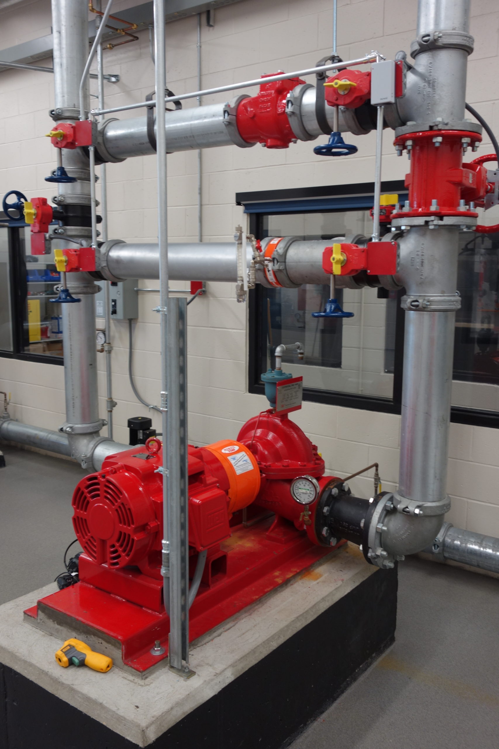

Three distinct means of providing for variable speed pumps are addressed by NFPA 20. In all cases it is the speed of the pump driver that is adjusted. The speed of an electric motor drive, as illustrated in Figure 3, can be regulated by a specialized type of fire pump controller (reference to paragraph 10.10 of NFPA 20). The controller regulates the speed of the motor by changing the characteristics of the electrical energy sent to the motor.
The speed of a diesel engine drive, as illustrated in Figure 4, is regulated by controls on the engine itself (reference to paragraph 11.2.4.3 of NFPA 20). The engine controls adjust the rate of fuel supply to the engine. The third option is what is defined as a self-regulating variable speed fire pump unit. This is a factory-built integrated fire pump unit consisting of a pump, driver and variable speed control unit configured to maintain set pressures (reference to paragraph 4.8 of NFPA 20).

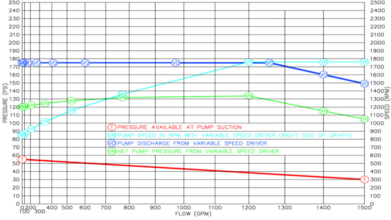

Regardless of the means of variable speed used, the overall intent is to limit the speed of the fire pump so that pump pressures do not exceed specified values. Referring to the 1,000 gpm at 150 psi pump example, it can be observed that excessive pressures, above 175 psi, are produced by the pump installation for flows below approximately 1,150 gpm. This occurs when the pump operates at its rated speed of 1,760 rpm. With a means of controlling pump speed, the high-end pressures produced by the pump can be capped to a set value, in this case to 175 psi.
Another theoretical example illustrates the application of a variable speed controls. The rated pump speed of 1,760 rpm is reduced for pump flows below approximately 1,200 gpm. Between this point and the churn condition, the pump speed is steadily reduced to approximately 850 rpm. The result is that pump flows ranging from the churn condition to 1,200 gpm will not result in pressures greater than 175 psi.
The modified pump curves developed through the application of speed controls can be applied by design engineers to inform other design decisions. For instance, variable speed drives can be used to increase the available pressure at the anticipated sprinkler demand flow. This in turn could allow for longer branch lines or smaller pipe sizes. The allowance for longer branch lines provides for more flexibility in the system layout that can result in a reduced number or arrangement of cross mains and feed mains.

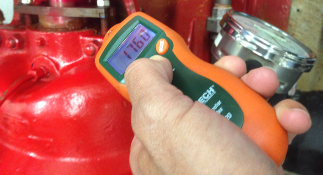

Figure 5: Application of a tachometer in verifying pump speed during a test. Courtesy: Milosh Puchovsky
Variable speed pumps present one of several options to the design engineer for addressing high system discharge pressures or low suction water supply pressures. Pumps with flatter performance curves, pressure reducing valves downstream of the fire pump’s discharge isolation valve, break tanks and low-throttle suction valves present possible other alternatives. Regardless of if a constant speed pump or a variable speed pump is used, verification of proper pump speed needs to be obtained during acceptance testing and follow-on routine testing per NFPA 25.
Figure 5 illustrates the use of a tachometer in verifying pump speed during testing. It needs to be appreciated that significantly more test points need to be verified for variable speed pumps. If at any time during its service life the pump operates at a speed other than what was specified by the design engineer, the performance of the fire pump and the overall fire protection system comes into question and requires prudent evaluation and correction.
