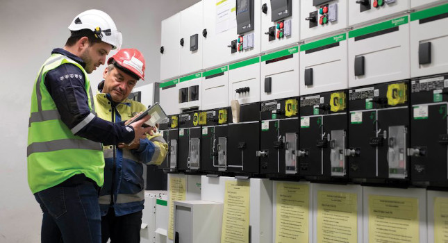

Figure 1: Proper maintenance can increase employee safety, machine uptime and process efficiency.
Figure 1: Proper maintenance can increase employee safety, machine uptime and process efficiency. Courtesy: Schneider Electric
