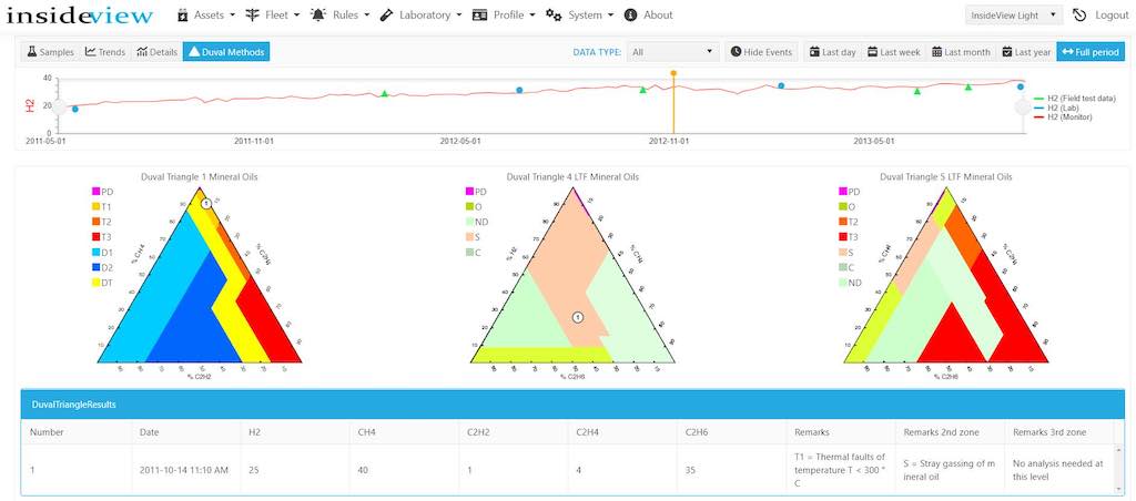

Dissolved gas analysis, or DGA, is arguably the most powerful tool in the industry when it comes to assessing transformer condition. Commonly performed according to ASTM D3612C and known as the headspace method (also detailed in IEC 60567), this diagnostic test measures the concentration of certain key gases dissolved in the insulating liquid. Additionally, if samples are taken at regular intervals, the rate of gas generation can also be determined. This information enables specialists to understand which faults are emerging and their severity.
While acetylene is the most important gas to measure for detecting severe faults, all gases are important from an incipient fault perspective. The types and quantities of gases that form within the insulating liquid will unveil the nature of the fault and determine whether it involves the solid insulation, is a thermal or electrical issue and whether there is a leak within the sealed system or premature degradation in an open system.
There are many recognized methods for interpreting DGA data — with insufficient time to review here — as well as suggested gas limits in guides such as IEEE C57.104-2019 and IEC 60599. Nevertheless, it’s important to remember that allowance must be made for factors such as the type of the dielectric liquid involved (silicone, mineral or ester liquids). However, a high-level summary of DGA interpretation (see Figure 1) would include:
  • Acetylene usually indicates arcing or a high-temperature thermal condition.
  • To check for partial discharge, look at hydrogen levels.
  • For low-temperature faults, pay close attention to ethane and methane.
  • Ethylene is an indicator of a high-temperature thermal issue.
  • In temperate climates, high levels of carbon monoxide are a sign of paper degradation, whereas in hotter climates, high levels of carbon monoxide can persist without other indicators of paper degradation being present.
  • High levels of carbon dioxide can indicate general overheating of the paper insulation.
Figure 1: Duval triangles represented in InsideView Software, a Doble Engineering Software. Courtesy: Doble Engineering
A single set of DGA data fails to inform us whether the gas concentrations are stable, increasing or even subsiding or indeed how long they have been there or if they are associated with a known incident like a transient condition or if they occur when the transformer is stressed in a particular manner. All that is known is that gases are present and the concentration of each. This may indicate an issue, but it cannot indicate whether there is an active problem.
Therefore, a trend of several data points needs to be established, which will inform the asset manager if the gassing is stable, becoming more intense or is progressing from one fault type to another.

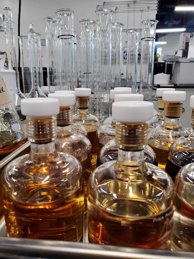

Figure 2: The foreground show special bottles used for corrosive sulfur testing. The background is graduated cylinders used in everyday lab activity. Courtesy: Doble Engineering

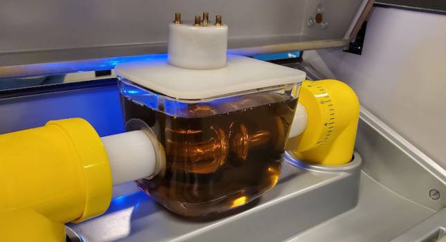

Figure 3: Breakdown voltage cell dielectric strength testing for insulating liquids. Courtesy: Doble Engineering

Transformer insulating liquids are designed to provide electrical insulation under high-electrical fields. Any significant reduction in the dielectric strength may indicate that the insulating liquid is no longer capable of performing this vital function. Breakdown voltage is a measure of the electrical stress the insulating liquid can withstand without breaking down. The test is conducted by increasing the voltage between two electrodes within a test vessel containing the test insulating liquid until the insulating liquid breaks down. Sampling technique plays a significant role in obtaining meaningful breakdown voltage results, particles and fibers accidentally introduced during cleaning the test cell or sampling bottles (chamois leather, cotton rags, paper towels) can all drastically reduce the measured result.

Other insulating liquid quality tests such as acidity and relative density can be performed in tandem for a more in-depth examination of the characteristics of the insulating liquid. It takes gross contamination, aging or overprocessing for these properties to change significantly, so if either of these values fluctuates between tests, it could be cause for concern. If an issue with the insulating liquid does present itself, there are other investigative tests that can be employed.
