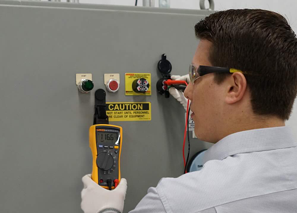

Figure 1: A qualified worker using a portable test instrument to test for voltage through a UL 61010 test point permanent electrical safety device (PESD). Courtesy: Grace Technologies Inc.

Permanent electrical safety devices (PESDs) listed to UL 61010: Safety Requirements for Electrical Equipment For Measurement, Control, and Laboratory Use can play a vital role in this process by providing a means to verify the absence of voltage without direct exposure to electrical hazards, thereby supporting compliance with NFPA 70E’s approach to electrical safety.
Specifically, when used with an adequately rated portable test instrument, test point PESDs help in the verification process of the absence of voltage, complementing step seven of the LOTO process by allowing for safer and more efficient verification before and after work is performed. This enhances compliance with NFPA 70E by integrating technology that makes the verification process less invasive and reduces the risk of exposure to electrical hazards.

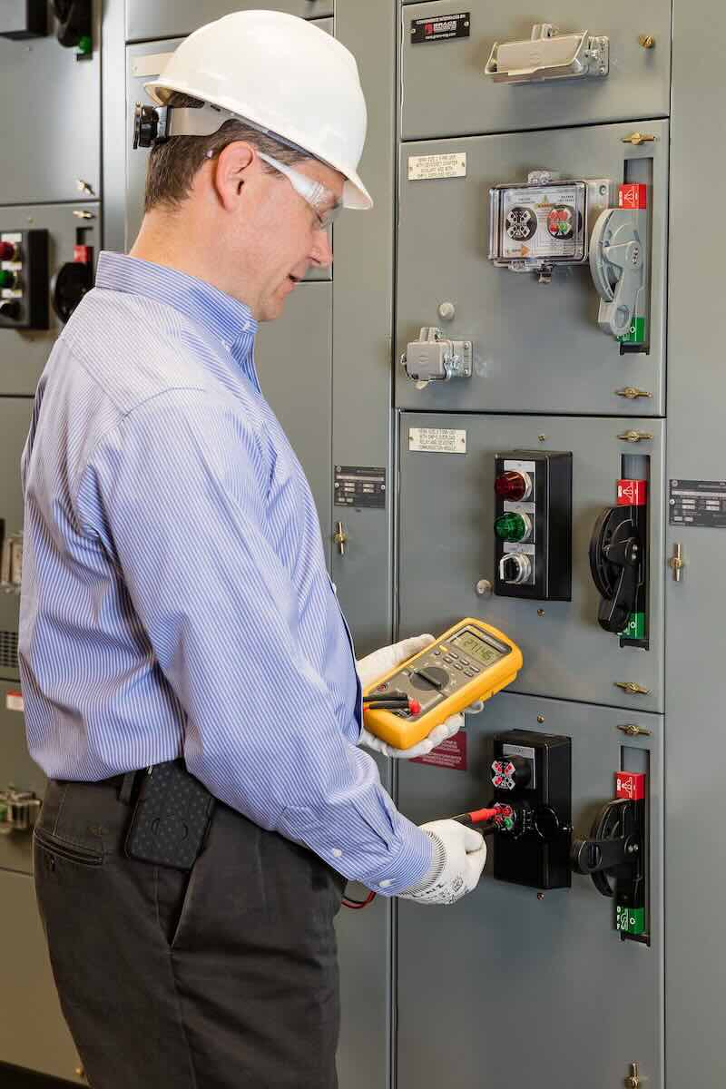

Figure 2: Voltage verification using a handheld testing device through a UL 61010-certified permanent electrical safety device (PESD) test point, ensuring an efficient and compliant procedure. Courtesy: Grace Technologies Inc.

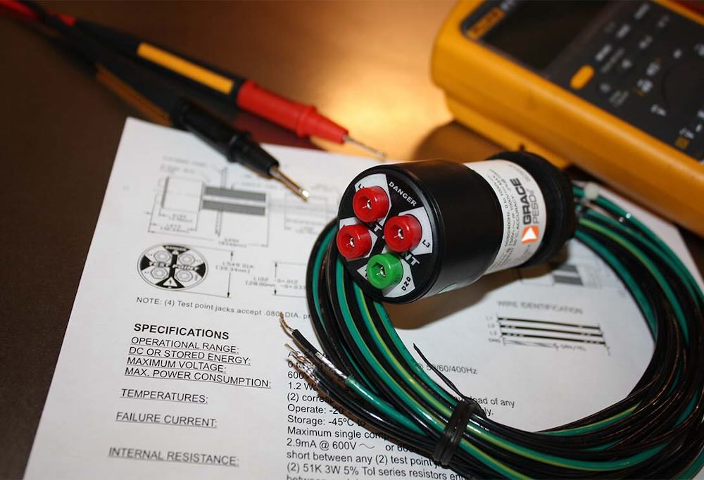

Figure 3: Portable test instrument taking a reading through a UL 61010 test point permanent electrical safety device (PESD). Courtesy: Grace Technologies Inc.

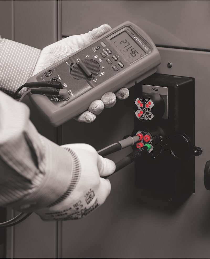

Figure 4: High impedance protected test point and multimeter. Courtesy: Grace Technologies Inc.
