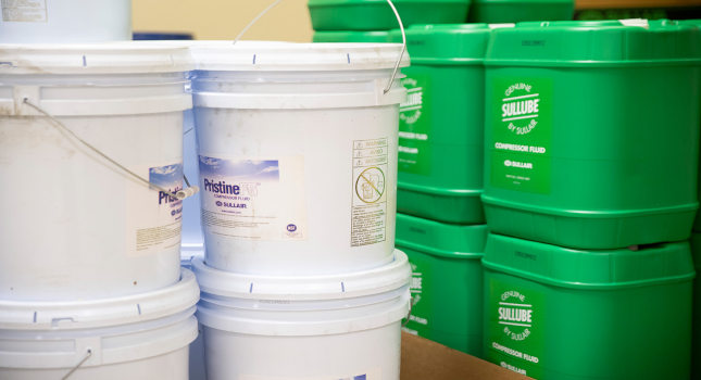

High quality lubricant will prevent varnish, has a higher thermal conductivity to help the compressor run cooler, and can be recyclable. Courtesy: Sullair, LLC
