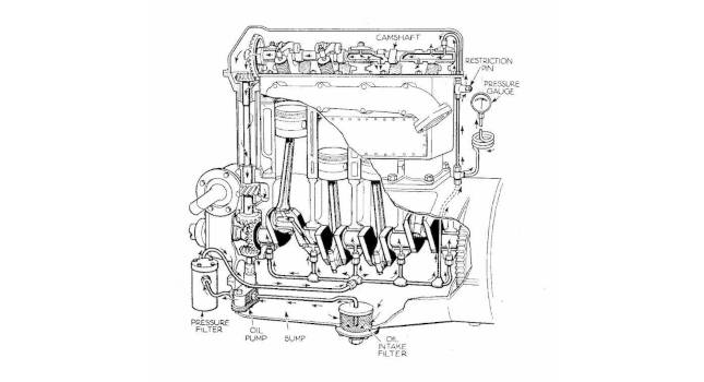

Engine crankshaft and camshaft bearings are fed lubricant via oil passages in the shafts providing enough lubricant film to create full fluid film lubrication, or a hydrodynamic lubrication regime, in the bearings when the engine is operating at normal speeds (see Figure 1). Demand for improved engine efficiency has resulted in lower viscosity engine oils used today to reduce the internal friction of the engine. Fortunately, better machining of the engine bearings, i.e., smoother bearing surfaces, enables a hydrodynamic lubrication regime to still form with lower viscosities. This relationship was examined in the article titled “The Stribeck curve.” This thinner lubricant film does result in greater particulate contamination sensitivity – i.e., cleaner oil is even more critical.
Figure 1: Engine lubrication. Figure courtesy of Andy Dingley (scanner) - Scan from The Autocar (thirteenth edition, circa 1935), Autocar Handbook, London: Iliffe & Sons, Public Domain, via Wikimedia Commons.
Figure 1: Engine lubrication. Figure courtesy of Andy Dingley (scanner) – Scan from The Autocar (thirteenth edition, circa 1935), Autocar Handbook, London: Iliffe & Sons, Public Domain, via Wikimedia Commons.
