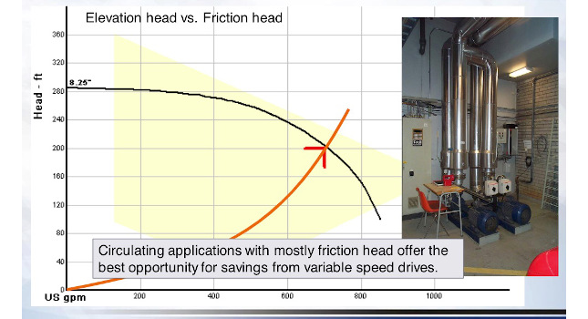

The operating frequency range (speed range) for a VFD depends on several factors. First, as frequency increases, the voltage must increase. The available line voltage is a limiting factor and the maximum motor Voltage is also a limiting factor. The motor may also have speed limitations, (a topic in itself). Aside from those limitations, VFD can output any frequency within the manufacturer design. Commonly that’s up to 120 Hz, but that varies by manufacturer.
The minimum pump speed to maintain flow depends on the system curve, especially the amount of static head. Obviously, that will vary by specific application.

This is a fascinating question. A specific rotodynamic pump has an efficiency curve for any specific speed; the curve defines efficiency at various flow rates. But the efficiency curve changes with the speed. And for any specific pump at any specific speed, the system curve determines the flow rate. So, for any pump, efficiency is a function of rotating speed and the system curve. So, an efficiency curve exists for a pump at one specific speed, or for a pump and system at various speeds, but not for pump alone at various speeds.

When a system requires flow control (operation at various flow rates), variable speed options can usually be justified, (VFD is only one of several variable speed options). When a system has a high static head component, it is much more difficult to justify variable speed options.
