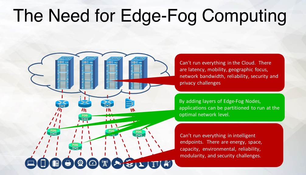

In the parlance of industrial automation, “the edge” has emerged as a term of considerable currency. The edge is found where the action is, at or near the industrial process.
To relieve bandwidth constraints or inherent latencies, and to improve system security and reliability, computational resources – from gateways to multi-purpose devices to computers -are being stationed at the edge. These computational resources located at the edge can filter or process data so that only what’s needed is transmitted between production control or enterprise systems and the cloud.

1. Please discuss some specific differences between edge, fog and cloud. Are edge and fog the same?
Chuck Byers: Edge and fog are very similar technologies. Edge is often a single (or few) layers serving gateway functions for a limited set of IoT applications, while fog tends to be more hierarchal and supports multiple tenants. Fog tends to have slightly stronger security and orchestration. Edge is a more common term in the industry, so IIC is migrating to using edge for the superset of edge and fog.
Steve Hilton: We generally use the phrase “distributed architecture” to capture the concept that data ingestion and process can happen at different points in the IoT architecture.
Ed Kuzemchak: Some practitioners use ‘edge’ to describe the actual sensors and ‘fog’ to denote one layer of processing above that. But that distinction is getting less clear, so I support the IIC’s move to using Edge for both.
