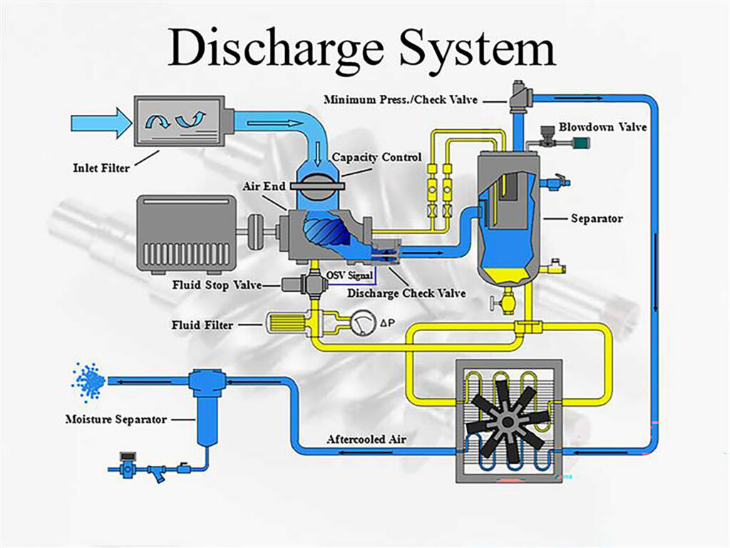

The BDV is probably the second most important valve on the compressor package for system control. With each load cycle, there is a chain of events that occurs: when a load signal is initiated, load solenoid changes state, inlet valve opens, BDV closes, MPCV opens, flow and pressure increases. As pressure reaches the unload setpoint, inlet valve modulation has reached its maximum and the reverse occurs: load signal drops off, control solenoid changes state, inlet valve closes, MPCV closes and the BDV dumps all the hot humid air to the atmosphere. Without a properly functioning BDV, there is risk of over loading the drive motor, over pressurizing the plant and lifting the PRV (see Figure 2).
Figure 2: A flow diagram that shows a basic oil flooded compressor discharge system. This includes control related valves, components, lubrication and cooling systems. Courtesy: Hitachi Global Air Power

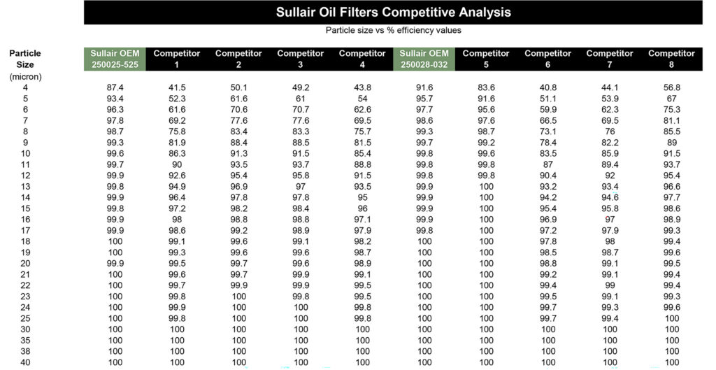

Figure 3: A chart that shows OEM versus non-OEM oil filter performance for particulate count and efficiency percentage. Courtesy: Hitachi Global Air Power
Oil condition and sampling are also a part of the OEM conversation. Contaminated oil can create havoc in a compressor system. Oil foaming and carry-over can damage downstream equipment, and high particle counts can wear out seals and damage bearings. Additionally, there are many pirate parts being sold online. Oil filters are easy to duplicate but may not perform to the same standard (see Figure 3). A valve or seal manufacturer might ask, โ€œAre you using OEM parts and fluids?โ€
