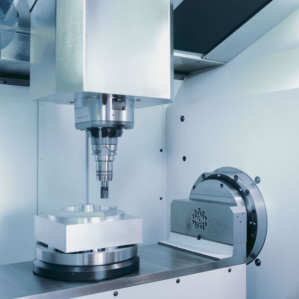

VFDs can be used to control the spindle of a CNC machine. Depending on the material and tool, different speeds are desired. Courtesy: Bosch Rexroth
Edward Polzin: The application requirements such as motor power, acceleration, maximum travel speed, and system stability are main concerns. Some applications may select a VFD device solely based on the power requirements. For precise positioning applications, it may be necessary to have a feedback device for velocity and position control.

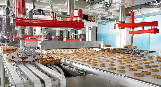

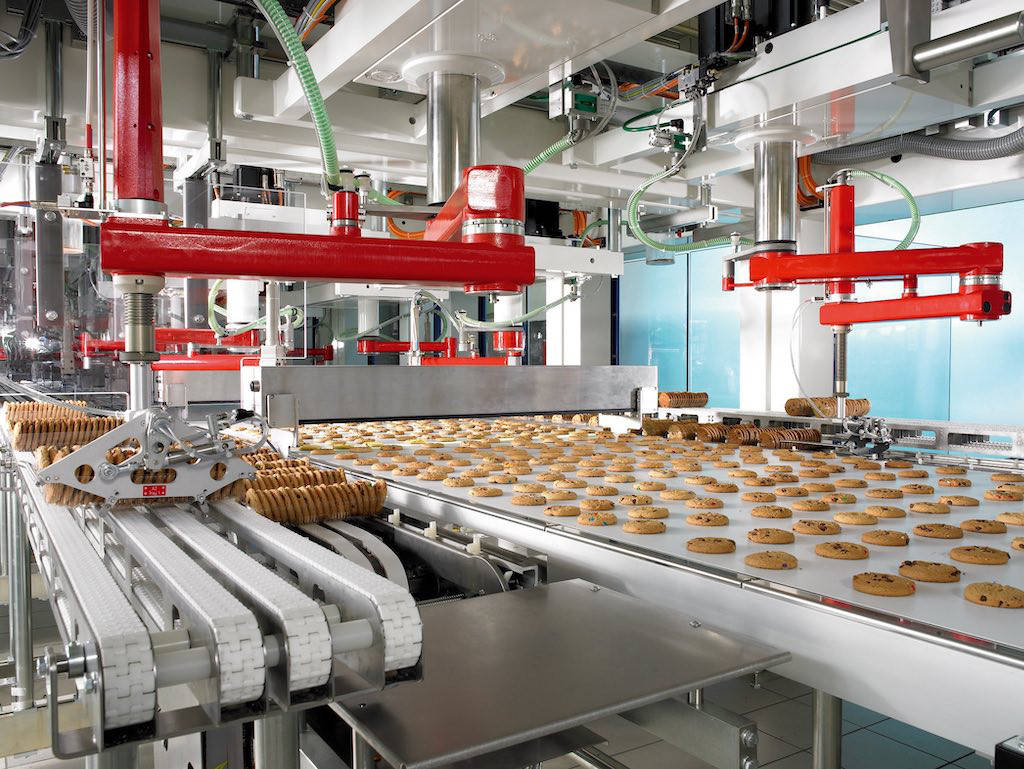

VFDs are often used to control the speed of conveyor belts. This example shows multiple conveyor belts that operate at different speeds. Courtesy: Bosch Rexroth
Edward Polzin: New semiconductor technologies help to decrease in size of the devices or increase power density. Lower loss semiconductors are becoming more economical which can increase overall device efficiency and lessen the need for large heatsinks. This also enables environmental sealing of devices, enabling out-of-cabinet drives to become more economical. Finally, newer semiconductors offer higher switching frequencies which help to reduce the audible noise.
