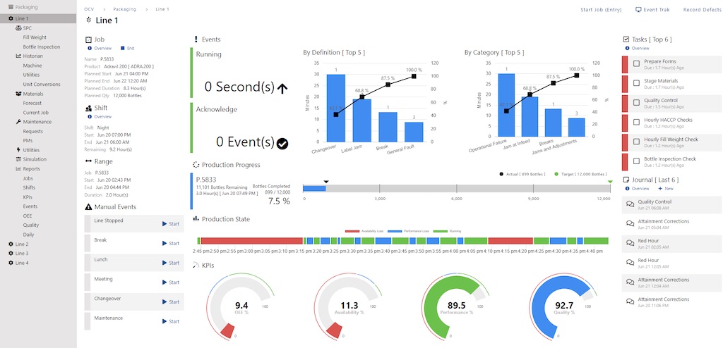

Figure 3: A screen shot from TrakSYS manufacturing execution system (MES) platform from Parsec Automation Corp. Courtesy: Polytron
To avoid this issue, we recommend considering more comprehensive technology platforms that support many or all MES functionality with a common user interface, back end, dashboards and reporting
