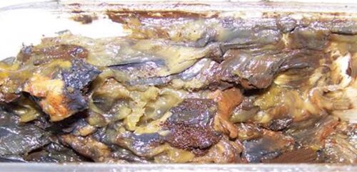

Types of grease contaminants
Figure 1: An example of different greases mixed in a bearing. Courtesy: CITGO Lubricants
Though hard to identify, it is important to understand the types of contaminants to look for to implement effective prevention and maintenance of the product:
  • Solids: External contaminants such as dust, dirt and debris can enter grease through open bearings, poorly sealed components or improperly stored grease. These particles can cause abrasive wear and friction on moving parts and degrade the grease’s effectiveness.Ā Bearing material caused by wear can further contaminate the grease causing increased wear and promoting oxidation within the grease.
  • Water: Moisture can enter grease through condensation, leaks or direct exposure to water. Water contamination can lead to grease breakdown, reduced lubrication properties and result in rust and corrosion.
  • Chemical contaminants: Exposure to harsh chemicals and solvents can alter the chemical composition of grease, affecting its performance and stability.Ā In addition, process water used in the facility can be extremely corrosive and cause increased wear in unshielded bearings.
  • Cross-Contamination: Using different types of grease or mixing incompatible greases can lead to a number of performance issues, resulting in grease that does not provide the right lubrication and protection.Ā Incompatible thickener types can result in the grease softening or hardening in service. Incompatible additives may compete for surface area resulting in increased wear and corrosion of the bearing surface.
